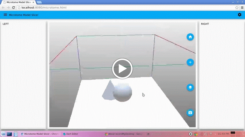

Slicing software for my ~$1000 dlp printer project.
Slicing software for my ~$1000 dlp printer project. Slicing done entirely in GPU and GLSL. This is a ‘preview’ mode, allowing you to use shift+UP/DOWN Arrow to see the slices.
This is mostly a smoke test, but it shows me the camera and GLSL shader is working correctly.
So I plan on marching ahead, and building out the rest of the software around the basic slicer, and then improving the slicer further.
Just a note, this a screen cast. The slicing preview is buttery smooth IRL.
And once I get the overall app fleshed out more, I will provide a way to preview the slicing in 3D

Okay. Just got the first inklings of support generation working. Developing a ‘lattice’ shader that will generate a suppport lattice. then need to integrate with multipass rendering to get lattice generation, masking, etc all working together properly.
