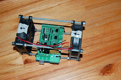

Hi. My Pololu drivers came with heat sinks attached. No choice. I like Daniel’s idea. I have some 20mm UHMW-PE rod .
