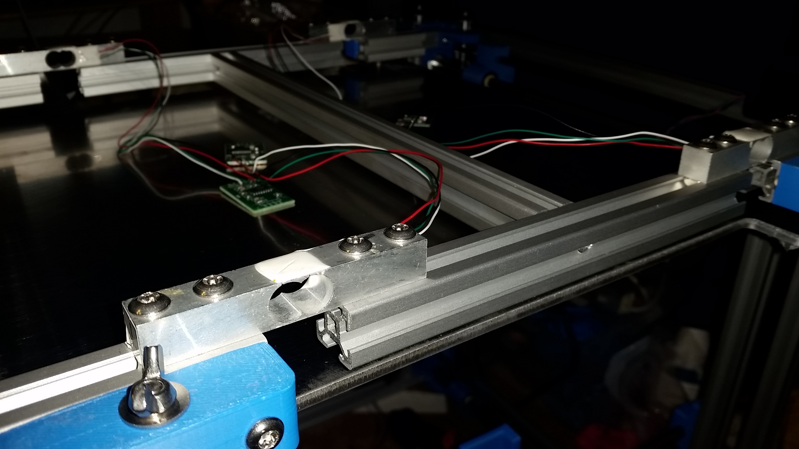

Small update: I received my second ball screw and finallized the mechanical design for the pressure sensitive bed for Z axis calibration. Now i need to create a circuit board for the arduino and mounts to hold the cell sensors.
