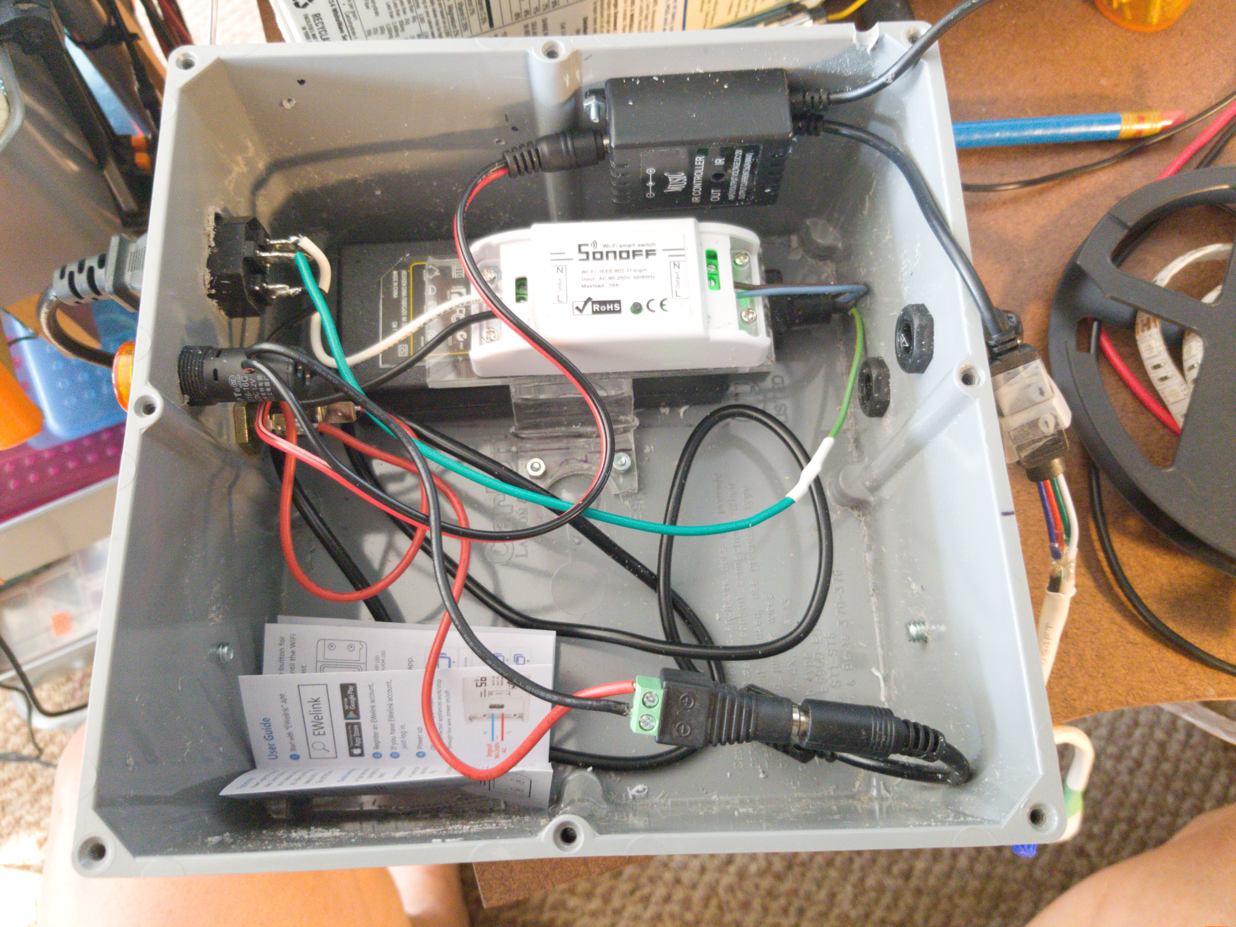

The design and fab:
Mounted in a large junction box under eves

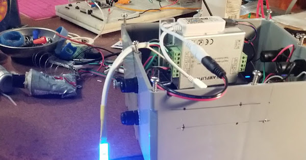

The controller (wifi controller, repeaters and second-string power supply not installed yet):

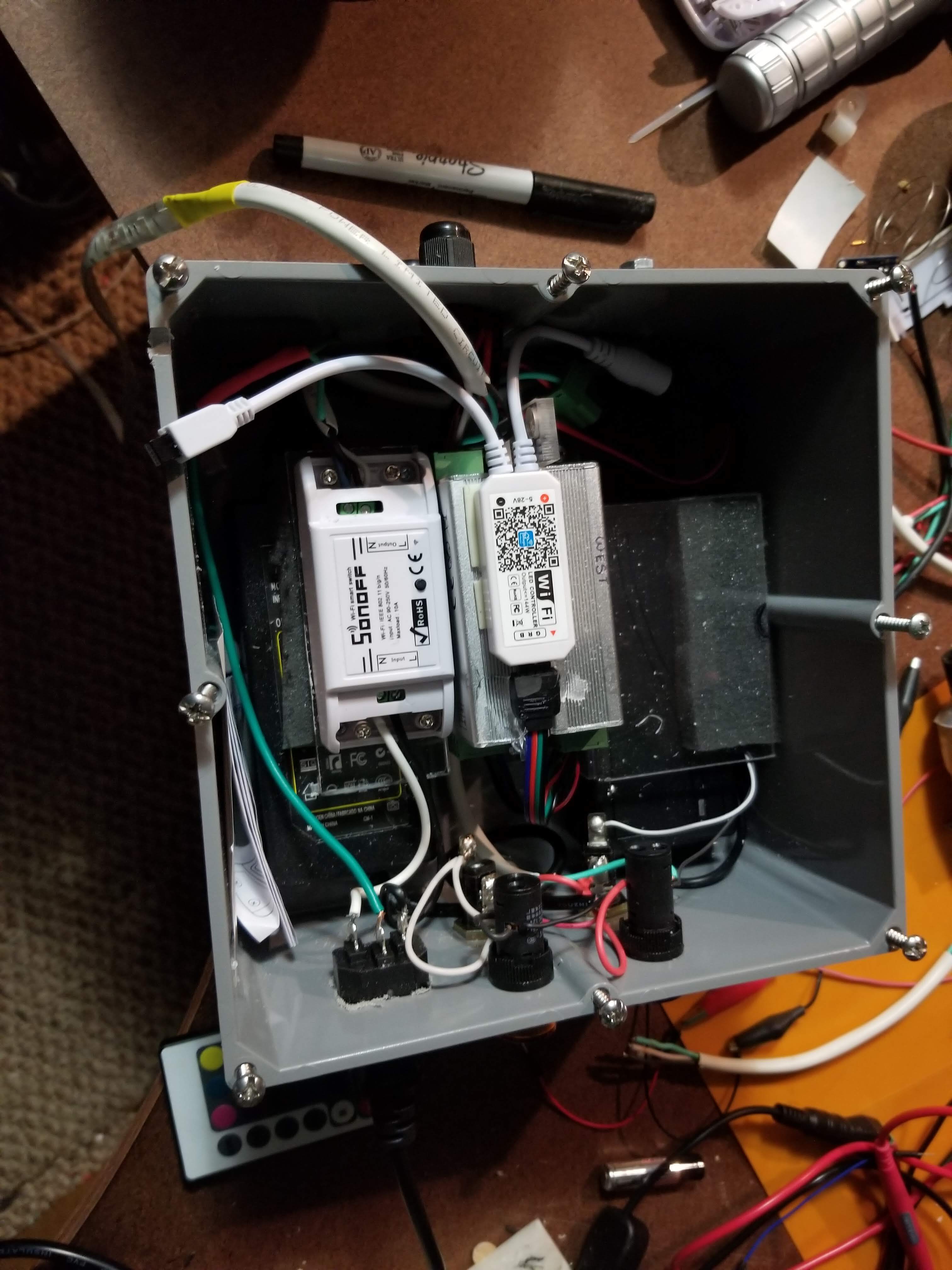

I completed the next phase of my holiday lights project.
  • Installed west channel electronics into the controller box
  • Installed 2x RGB drivers
  • Installed voice-activated light color controller.
A planned build video is in my delinquent QUE. If anyone wants more info before then, let me know and I will accelerate its creation…
The controller now has 2 channels with RGB drivers for each. One goes east and one goes west.

The final build:
Controls:
Turn the entire unit on and off from mobile remote or Google Assistant
Adjust the colors, brightness and program from mobile app.
Adjust the colors and brightness from Google Assistant
