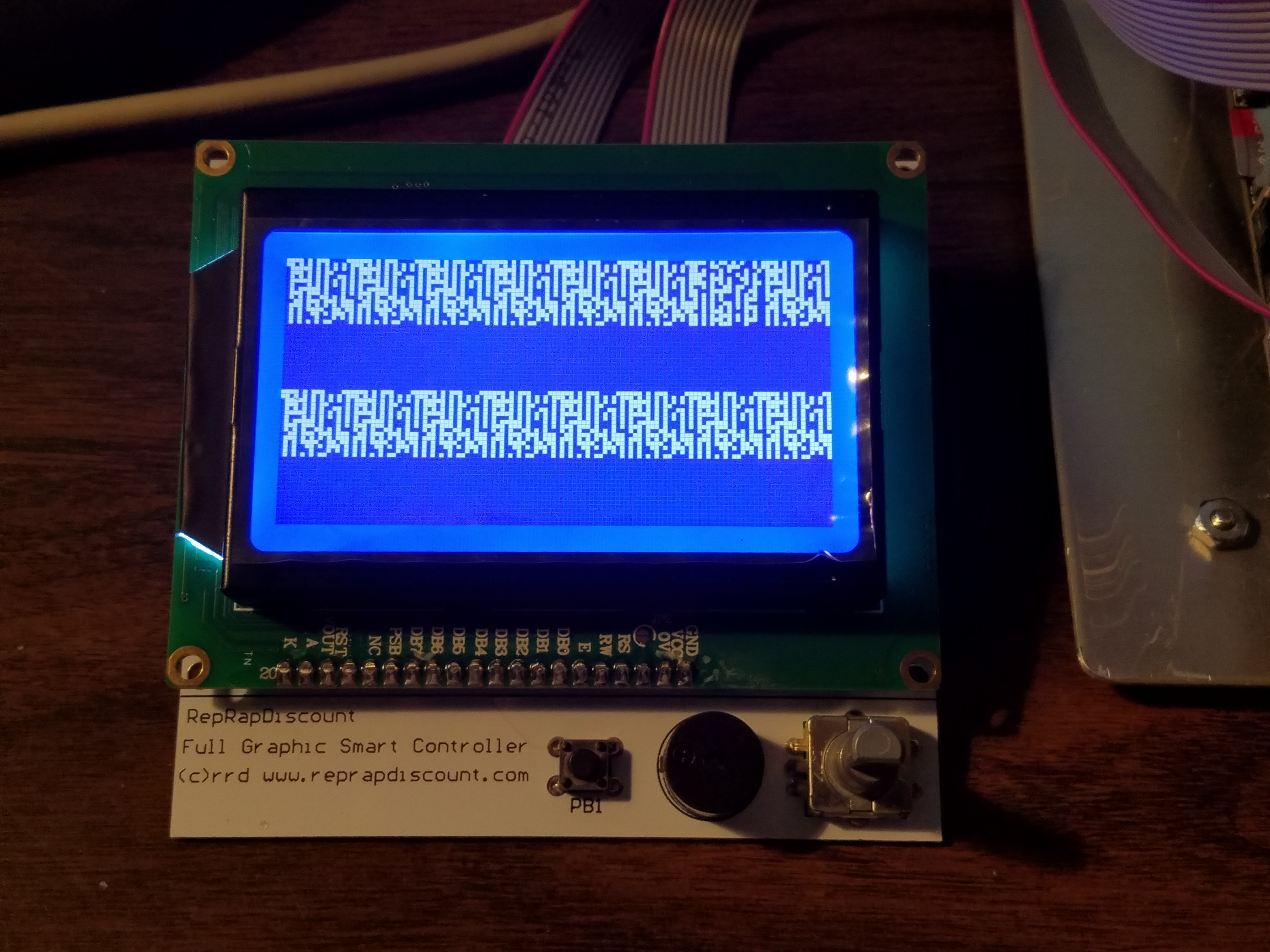

Well I pulled the controller out of the laser so it would be easy to work on. This is what I saw when I powered up the board. Took a couple of tries and then it came up and displayed correctly. Sometimes the whole screen was snow. In all cases pressing the encoder button would produce beeps
When it came up normally I saw this:
As far as your voltage test, 4.96 to 4.98 volts at the display board. Power to the controller is a 24v 1.1A supply set to 21v

FYI; my display sometimes boots up with garbage. Its always done such … for years!

Upon bench testing this it took 3-4 cold boots to get the display to come up, at all or not garbled. I was using a 24v 6.5 amp supply at this time. Once it came up correctly, it failed to mess up from then on.
Next step was to install in the machine. At this point I had issues with the display not coming up and removing the ribbon cables in the machine which were 16" long and replacing them with the shorter cables included with the displays (I own two of the white board units) got it working.
