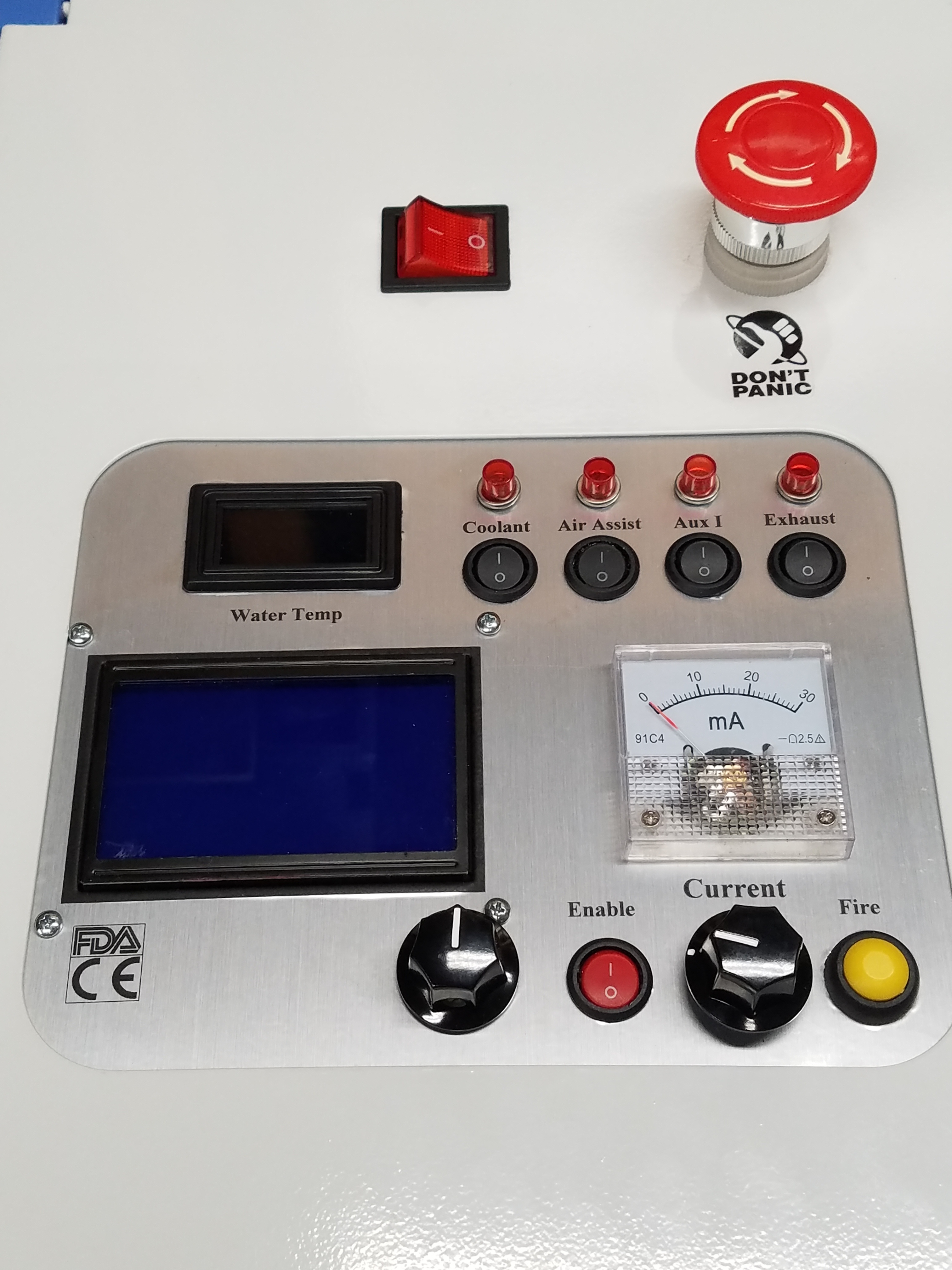

Problem is, about 50% of the time when powered up the smoothie will not start and I get a continuous tone from the display board.
Looking at the LED’s I have Red/Red/Grn/Grn/Grn/Grn ( all are on solid )
If i press the reset the board will come alive and run. Once up and running the laser works flawlessly. Powering it down and waiting until the power LED on the board goes out it will start with the same percentage of chance.
I am pretty convinced it is a power supply issue, but before I order the specified 5V regulator and eliminate the separate power supply, I figured I would through the question out here.

Well the “official” voltage regulator showed up and has been installed.
Unfortunately it made no difference. Still hangs with a continuous tone and a lighted display only until you hit the reset button. Hangs about 50-60% of the time. After hitting reset everything is fine.
35+ years of doing driveability and computer diagnostics on cars prevents me from just wiring an external reset button that is easy to push. :stuck_out_tongue:
Voltage input to the controller was checked to make sure it did not exceed 24v and has been set to 22v just to be on the safe side.
edit One thing that popped into my mind (of course after hitting send) was could it be the GLCD hanging? Too tired to go back out and see it LightBurn can see the controller despite the display being blank.

with the installation of the “official” 1a voltage regulator onboard I believe voltage is a non issue.
After posting last night I went out and unplugged the GLCD cables and the board boots normally and repetitively.
I am not sure if there is a preferred source for these GLCD panels, I plan on sourcing a different brand
Some GLCD’s ship with one of the cables reversed. This my be the issue with yours. I know Cohesion3D.com sells quality GLCD panels on their web site.
I am familiar with the connector issue. I currently have three of these panels in use, two have the backwards connectors.
If they are backwards you get the same effect (back light and tone only), however pressing the Smoothie reset button will not bring it to life.
On this installation, pressing the reset boots the board and it works normally.

Ok, the real deal arrived. Do these need to have some sort of firmware update in order to run? No documentation was included and the display back light comes on but nothing else.
I have searched the RR site for any firmware information and all that i find points me to the Marlin site.
Cloned glcds have their connectors rotated 180 degrees relative to the real glcds, so if you go from one to the other you’ll need to pop your connectors around.
That’s not the issue here as I was testing the new display using the cables supplied. So I have: Smoothie 5c, Uberclock display adapter, 5v 1A regulator on board the Smoothie, genuine RRGLCD.
