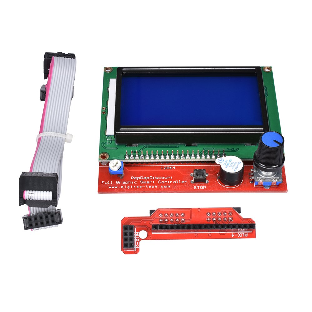

I have tried to get a panel working with my smoothieboard but the backlight doesn’t even turn on.
I have tried rotating the connectors on one side and it is possible I got them mixed up between exp1 and exp2 when doing this. I also at one point mistakenly had one connector one way up and the other the other way.
I have a smoothieboard v1 and have made the required change to the adaptor board though not before first trying it without that change.
I’m trying to connect to the below panel:
https://www.amazon.co.uk/KINGPRINT-Graphic-Display-Controller-Adapter/dp/B079BWK8PD?pd_rd_w=exyIC&pf_rd_p=ddea60e1-d3d8-4bd7-9263-0e65440a0100&pf_rd_r=YHYM1QPWXGPV9GY0FANZ&pd_rd_r=54c9e0bc-cb7a-4665-80ba-dd953cb6a4b1&pd_rd_wg=ySbVt&pd_rd_i=B079BWK8PD&psc=1&ref_=pd_bap_m_rp_4_sc
I have a 24v power supply and the 1 amp 5v voltage regulator.
On the adaptor board I can see 4.7v over the 5v / gnd pins.

The smoothieboard appears to be operating normally just not lighting the LCD.
Any help would be appreciated.
Thanks.
Do you hear beeps when turning the knob? If not it’s likely not wired correctly (or it’s just bad/broken), if you do, it likely means the contrast/backlight is set too low, and you need to find the potentiometer behind the screem to fix that. I can’t see any way this would be config-related, this is a hardware or wiring issue.
Thanks. I don’t hear any beeps and the stop button doesn’t seem to do anything either. Can you recommend any other multimeter measurements to make on either the adaptor board or glcd. I would like to rule out user error or bad soldering on my part before buying a new LCD.
Try to find the potentiometer, it’s often hidder behind the screen. Otherwise I’d say the glcd is likely bad.
