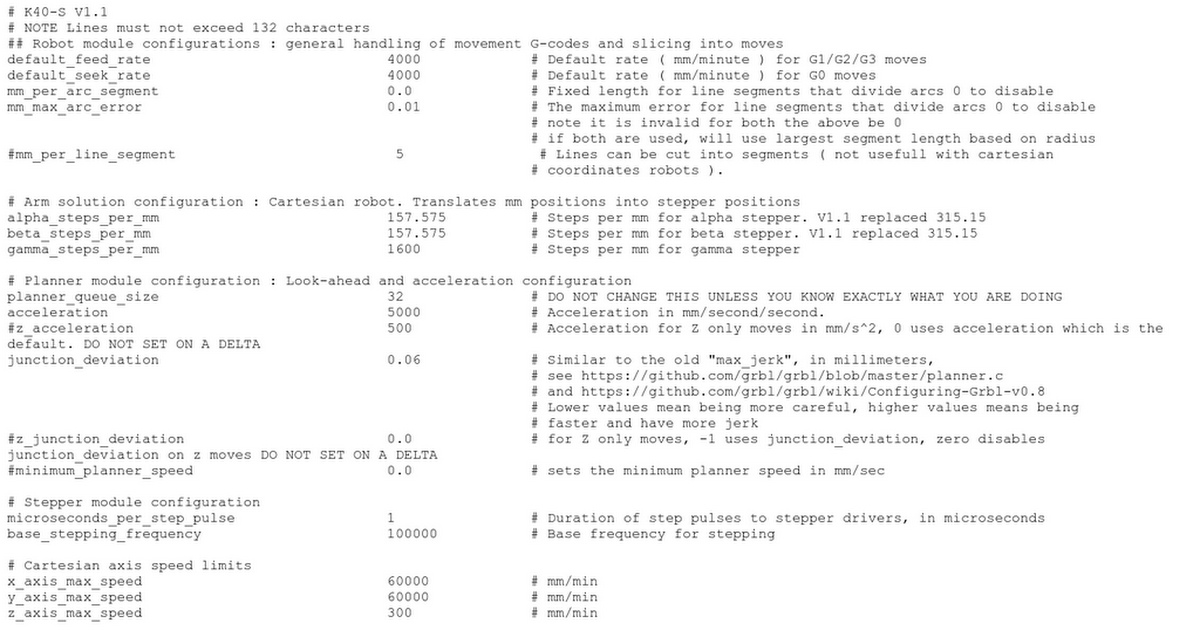

Post your configuration file.

Here is my config: https://pastebin.com/raw/5fcX6iYL
Also the motors don’t have anything writte non (like model nr.). I measured them and came to conclusion they should have 1A. Also tried setting the config to 0.5A, didn’t change any behavior.

Look at my working K40 + Smoothie configuration file and try it.
Your stepper values are quite different than these
