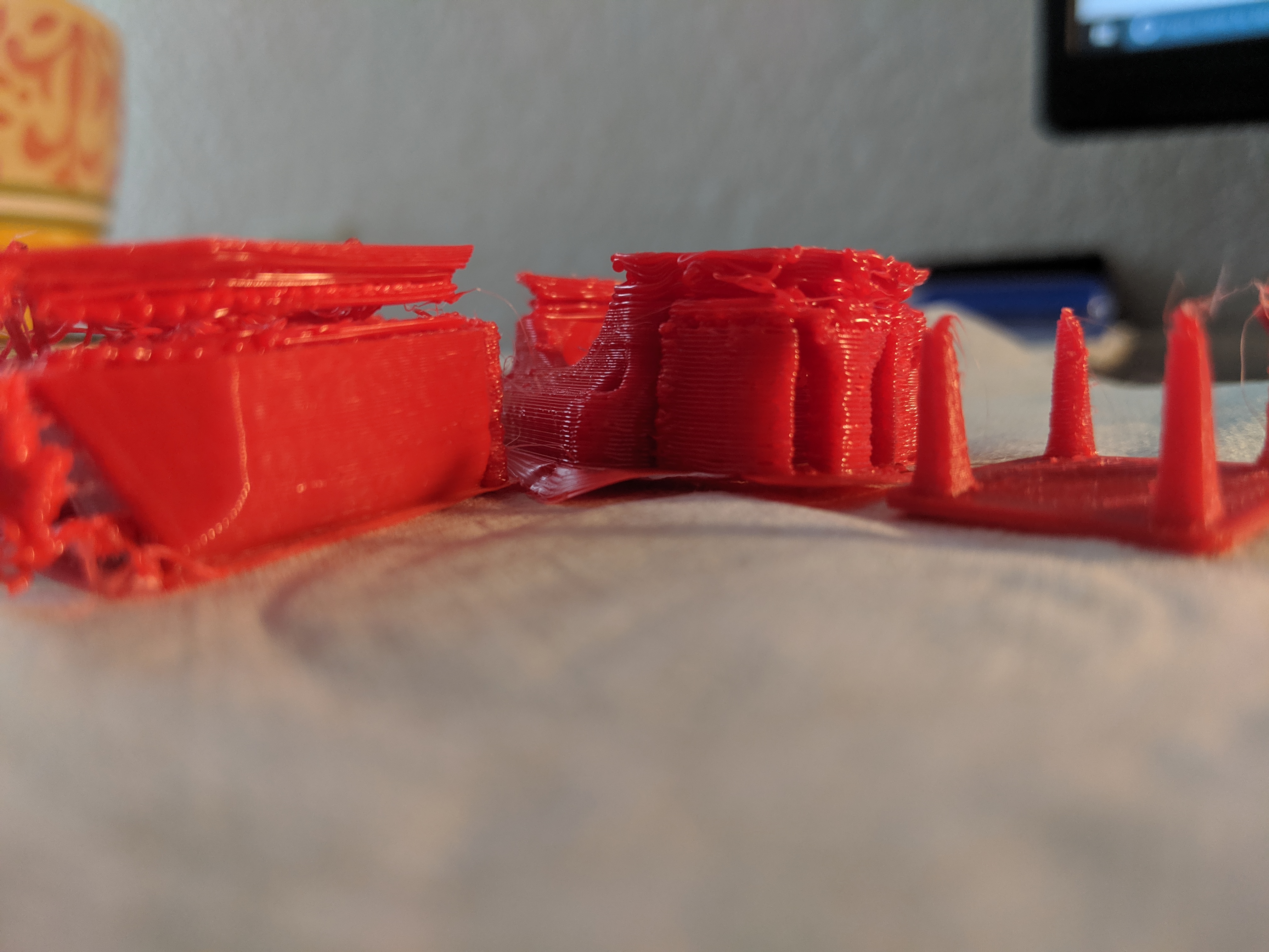

- Shifting layer at the same height every print
I am having a problem with my board suddenly changing the z-axis position of a layer mid-print. This failure is happening at the same height of every model I’ve been printing.
At first I thought the issue was mechanical, so I checked/adjusted extruder tension/current, missed steps for z-axis and extruder, motor current, filament grinding, filament tangles, temperature adjustments, retraction settings, clogs, etc.
When I was testing retraction settings I finally watched the failure occur. During a layer change, my printer will move the bed down farther than a regular (at least twice as far) and then not return to the correct height. It will do this for a couple of layers and then return to normal (although I’d eventually abort the print, so it may continue to happen later). This happened even with retractions turned off. What I suspect is either A) entire blocks of gcode are being skipped or, B) the gcode command for the layer change is occurring and the bed will move but the firmware is not updating the current position.Then the layer change is repeated, resulting in a gap.
What I don’t know is how to test this and fix it, should that be the actual problem. Any ideas, anyone?
