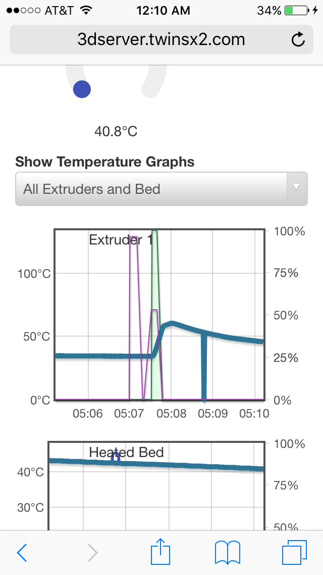

So 10 hours into a 12 hour print and my printer said dec where
So 10 hours into a 12 hour print and my printer said dec where the hot end temp goes… Decoupled? If so how do I fix it? It stops the print but the temp is still reported to repetier server. It is a davinci 1.0 flashed with repetier. The filament sensor and the thermocouple I guess have been acting up. Here is a graph of extruder temps… It has been dropping to 0 randomly and bouncing back up. All the wires seem fine

I believe it was a loose heater wire because the graph that I didn’t post the temp was dropping and then it popped up with an error. The heater wire has been pulled many times. Time for a new connection

I believe that the temp dropping to 0 isn’t the problem because it has done that since the start. I believe it is the heater wires because it will cool down or won’t heat up and then dec appears. Time to buy some connectors
