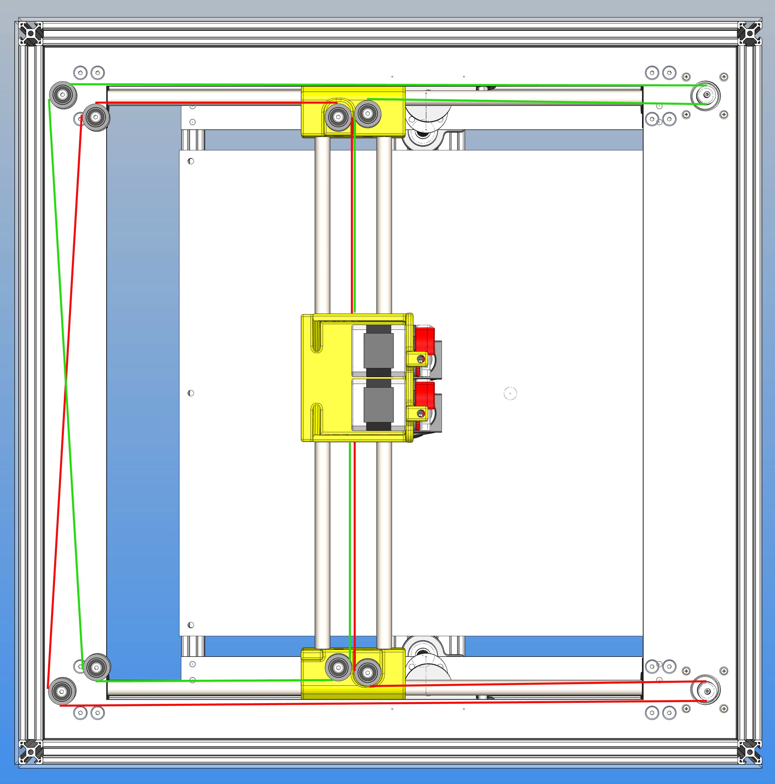

O ya Ive been looking at his design cant seem to see enough in his videos to see how he has it set up
No reason why you couldn’t use direct drive. Id use a nema 14 and an ez-struder or similar. Would need a new carriage design obviously.
@Chad_Nuxoll Here is a top view showing the CoreXY Mechanics:
Here is a 3D pdf that should be an easy way to roll around the model and see the workings:
Also here is the link to view the model in other formats (since I work in Solidworks natively):
