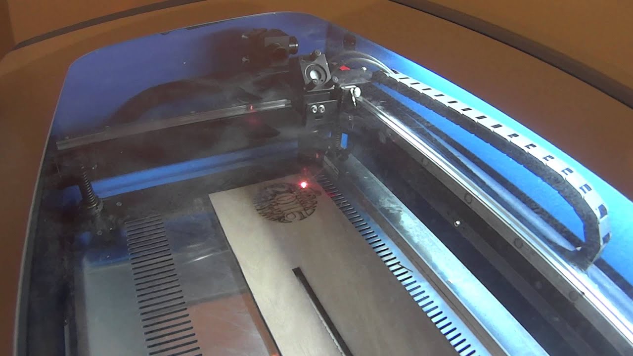

So all I’ve done with the monster today was spend two hours straightening the adjustable bed; one of the four legs was either to short or the bracket holding it on at the top is totally in the wrong place. possibly a bit of both.
Didn’t focus it, didn’t do anything else except do a test pulse to see if the tube worked. It did work and it was perfectly focused so I left it alone!
I’ve had some OK results so far…
That’s a cool design there. Very fine details too. Is that done using Cut or Engrave?
That was engrave. I think i’d still be watching it work if it was a cut
