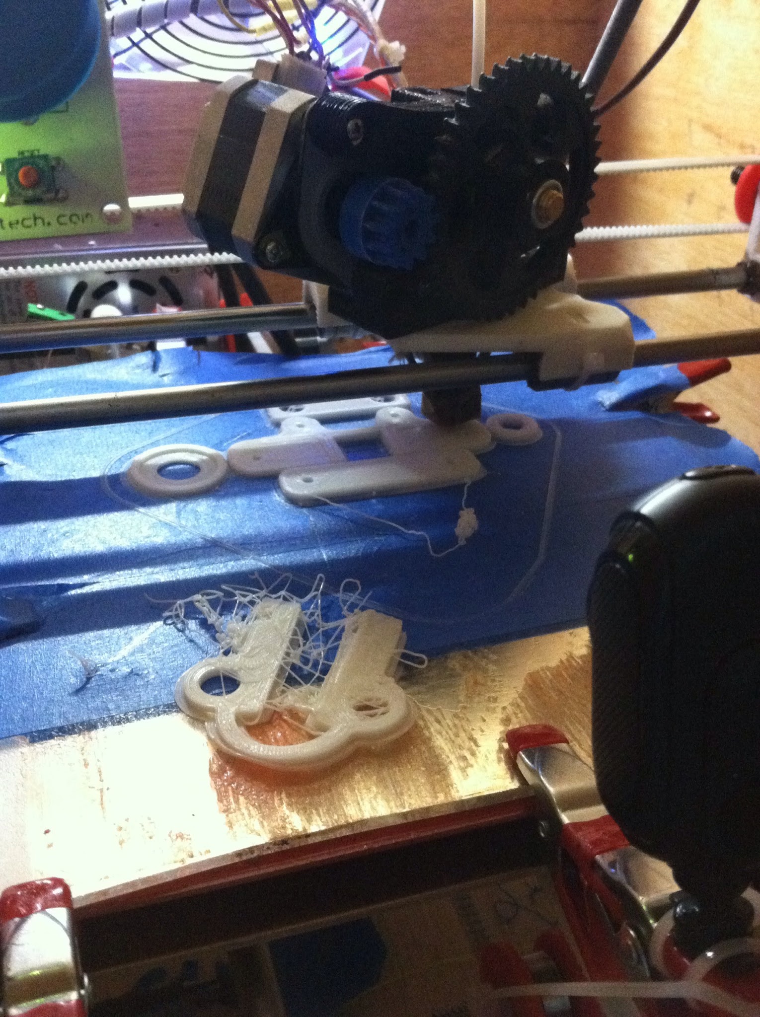

So apparently it’s harder to keep big prints down when printing with PLA and no heated bed in a room with crap temps… I got two good pieces out of it and it started to fail.

Ill keep that in mind next time I print with PLA. I read that somewhere and completely forgot about it.

Ya I have my brim set to 2 and was trying to link the brims to keep the parts flat on the bed… Worked accept that one part I didn’t split it with splicer first. Thanks for the tips on the ob1.4 I’m actually looking forward to building that printer.

The parts on the bed were a y idler a j head adapter, and a Bowden adapter for the j head. And a few other parts.

Something I also found with certain brands of blue painters tape - the tape itself should have a matt almost hairy finish. If it’s shiny, use fine sandpaper (eg: 800 grit) to scratch it up slightly. As mentioned elsewhere, avoid getting skin grease on the tape and/or wash the tape with isopropyl alcohol.
@Jeremy_G_WeisTek_Eng is your printer enclosed? I have found, even with a heated bed, if the temperature in the room varies or there is a draft my flat prints will curl up.
Ya mine is included in a monstrosity of a box
it works though i get way less to almost no warping with abs, although I need to fix some stuff with it though.
