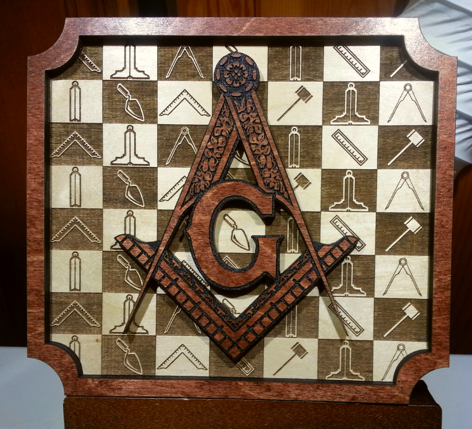

So been remixing the plaque design for other groups I’m involved with. The first one is Masonic, with the working tools of Freemasonry in the background. The other is for my college fraternity (Pi Kappa Phi) with the chapter name (Gamma Theta) in the background along with the pirate because we called ourselves the Gamma Theta Raiders.
I used the same compass and square about 6 months ago in black walnut… It turned out amazing https://plus.google.com/109807573626040317972/posts/DpwVRnvabB5
Beautiful work!
Are you staining the frame pre or post laser?
Pre laser. The frame and the center are both cut from the same piece. Stained, sealed with a couple coats of lacquer, masked, etched/cut and then the centerpiece etching painted.
