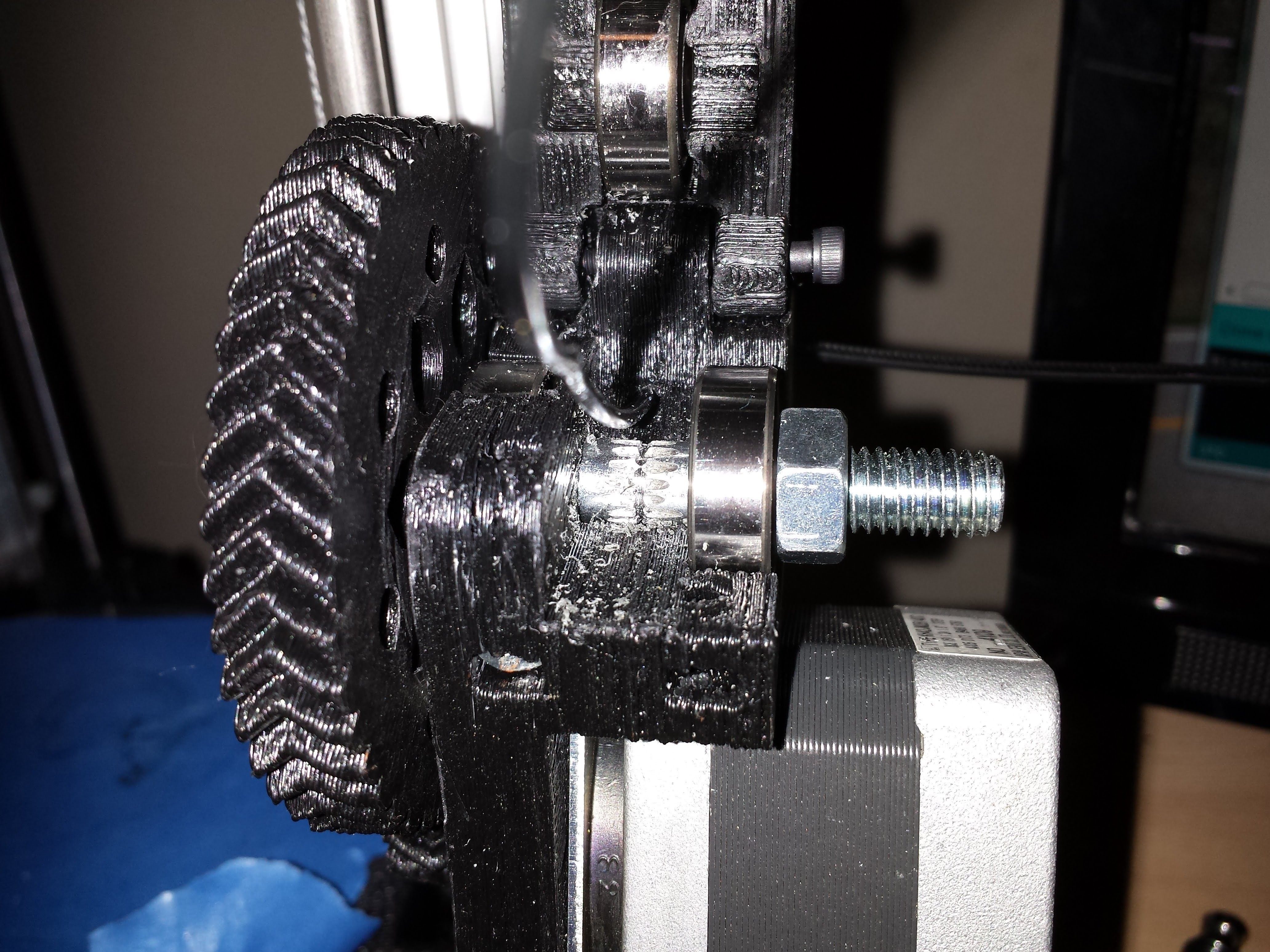

So close it’s killing me! Good smooth extrusion is eluding me. If I push the filament, I can get some plastic out, and migrating to the real pneumatic fittings and PTFE made things better, but I just can’t seem to get it to spit out plastic reliably. (.35 1.75 hot end)
When the hotend is hot, gentle hand pressure on the filament (with the extruder idler open) should let you push plastic out easily. If that’s not the case I’d start by taking the filament path apart and looking for a place where friction is too high. You might also have oversize filament, check the max diameter with your calipers…
You could perhaps go direct drive with the j-head and 1.75mm filament. You will then have more suitable drive gears to choose from. The teeth look too chunky on the bolt your using.

what mechanism is feeding the filament to the hotend?
It’s the standard 3DR Bowden setup, one of the debug issues is working out the tensioner as I had real problems getting one of the trapped nuts into the base without it delaminating. I get the impression a properly running system wouldn’t need a lot of pressure to drive the filament, especially with the aggressiveness of the drive bolt.
@Mike_Miller , you’d be shocked by how tight your tensioner needs to be. Try replacing with a spring tensioned design like the minimalist extruder. But regardless of your extruder and Bowden tube, filament going through a hot extruder by hand should only require pushing the filament with pretty minimal force.
Thanks, I’ve got zipties cranked down and holding it while two M3-35mm bolts are being sent to me…it’s the fringe parts in the build that are killing me.
