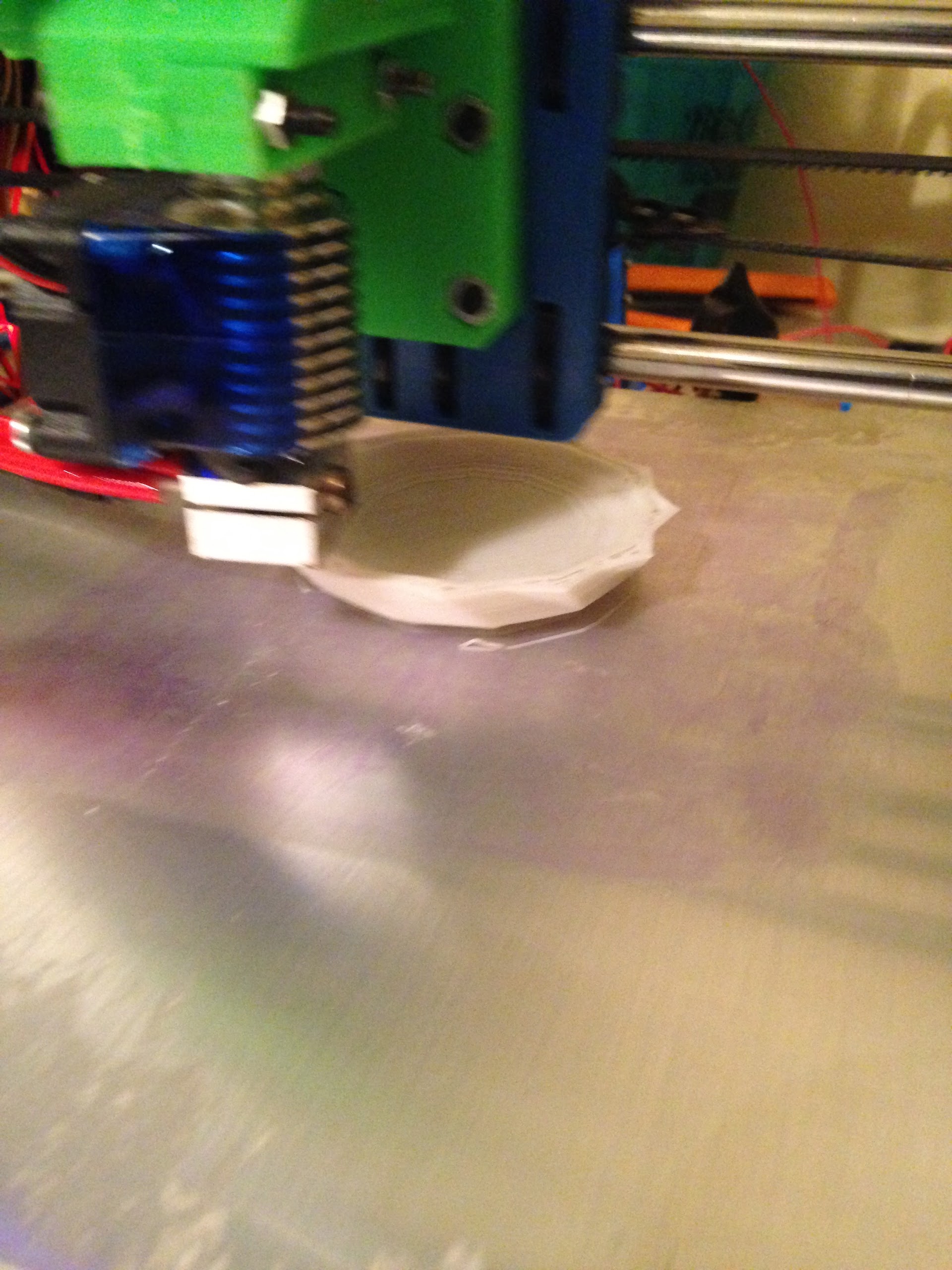

So here goes the new "blind" filament.
So here goes the new “blind” filament. I got a spool of glow in the dark (photo of print) and yellow. I’m setting way better improvements over the Chinese crap.
240c hotend
80c bed (90c was causing the washable glue to pull up)
.24 layer height (60% of .4 nozzle max I researched)
Speed 40
Infil 15%
And forgot the rest I had in slicer
Ordered some nema17 dampeners and installed a new stepper on the y axis (much bigger one)
how about a ‘dark’ pecture so we can compare with competing glow filament sources.
I’ll post some tomorrow. My iPhone camera won’t pick up that good.
