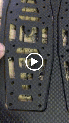

So here I go again, got my rapid slowed down that’s obviously not it. I am running the machine in my garage in Vegas in July/August Could the heat be having an adverse effect on it. In the video I show how it screwed up the same way twice, with a file I ran before that with no problem. So frustrated!

Is that carbon fiber mesh? The texture of the material looks odd.
@Steven_O_Neill what if it was not a matter of the tool moving, but instead a matter of the carbon fiber moving? Is the carbon fiber already epoxies or is it loose or glued to something?

Of course… If the stock can move you are going to get this problem. It’s machining 101… Double sticky tape the stock onto a non flexible back… Like a piece of flat aluminum. The heat in Nevada might have an effect but unless you take the other variables out, you will not see the machine ‘noise’.
I am starting to think that simple double sided tape to attach it to something on one side is not enough. I am starting to think that he needs to repeat the process for the other side. I think his carbon fibers may be yanking during the cuts.
