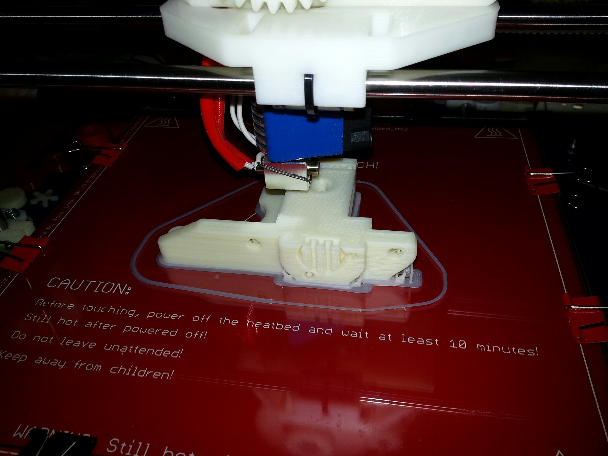

So here’s a lesson I learned. If you want to push the limits of your printer, Don’t print your extruder block out of PLA.
I replaced my original Mendel90 Wade’s extruder, that had cracked, with one that I printed out of PLA. The PLA softened due to heat from the J-head hotend, and the extruder motor, causing the motor to sag, and eventually the J head to become floppy in the mount, and the mount screws to stretch out the holes. When I originally tried to print this part out of ABS, I had several bombed prints because the part warped and started to lift.
So this time I re-glued the cracked original extruder with ABS/Acetone slurry, and mounted my new E3D hotend on it.
Printing at 250C, I was able to complete a fine print with no lifting. I’ll just hold onto this one as a spare, as the repaired original extruder seems to be holding up well. In the photos below, the white part is Protoparadigm ABS, and the green is Fabberdashery PLA.
Here are the settings I used on the successful ABS print:
Filament 3.0mm Protoparadigm ABS
Extruder temp: 250C (E3D-V5)
Bed temp: 125C - glasscoated with Aquanet hairspray
Slice: 0.2mm
Nozzle: 0.4mm
Perimeters: 3
Top & Bottom Layers: 3
Infill: 65% Honeycomb
Brim 3mm
Support: On, 2.5mm

Perimeter Speed: 30mm/sec
Infill Speed: 60mm/sec
First Layer Speed: 75%
Travel Speed: 120mm/sec
About 10 layers into it I cranked all the speeds up by 115%
