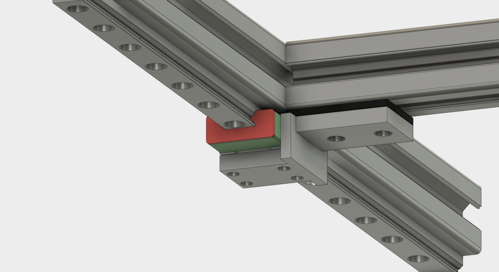

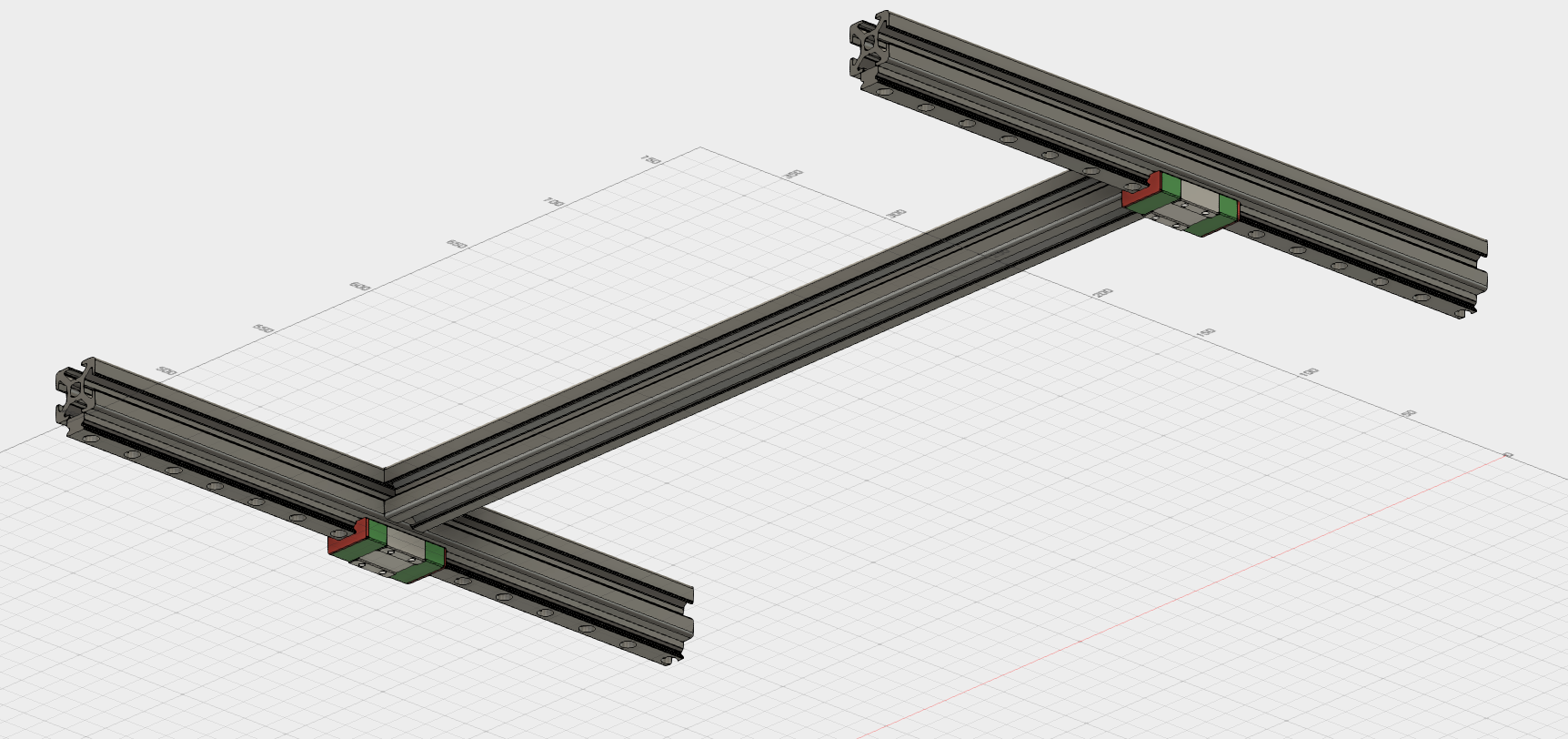

so how would you mount the x-axis to the y-carriages?
I have L-profile bridge with X rail on it in my home made CoreXY
This is what I came up with now. Should work well.
I did the Printrbot Big-E w extrusion, have to dig up the link, but it’s all flat waterjet parts. You could save yourself some time and look at what I did. It uses Delrin wheels tho. I’ll be posting my Prosthetic bot design soon, which started w rails on extrusion. I saved weight by just using linear rail for X instead of mounting it on extrusion. Depends on size. If you use L brackets, longer legs are better than shorter in my opinion. You could take a look at how used belt in a C loop instead of a jack shaft or two motors. It allowed a single linear carriage on each side and keeps the weight down.

This one or similar? Looks quite nice but I would like to avoid using wheels. However, will look at it closer. Thanks!
It has some L brackets. Wheels are ok for light duty but they come w maintenance. I’ve been transitioning to rails almost exclusively. Z axis is fine w rounds tho.
