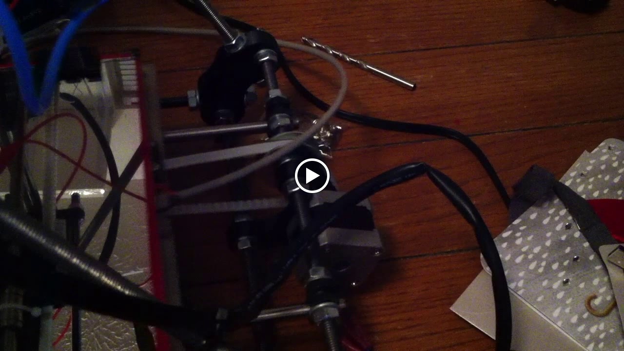

So I am almost ready to start printing. my x and Z steppers are working with pronterface. My y axis is fine and if I plug my z or x steppers into my y plug, they work. Any ideas? Video shows the problem in a bit more detail. Thanks for any help!

I swapped out the ramp on the y axis to the x axis slot and it moved the x axis motor, but not smoothly, still very jerky. are these symptoms of calibration?
The words on the video confuse me. Y should move the bed in and out, and X should move the extruder back and forth, and Z should move the X carriage up and down.
Is your problem that the the only port that seems to drive any of the axes is the port labelled y on the sanguino? All of the axes work as expected with the Y port?

Perhaps I have it backwards. I call the plate the x, and the extruder is on the y. I’ve tried tweaking the pots to no avail.
