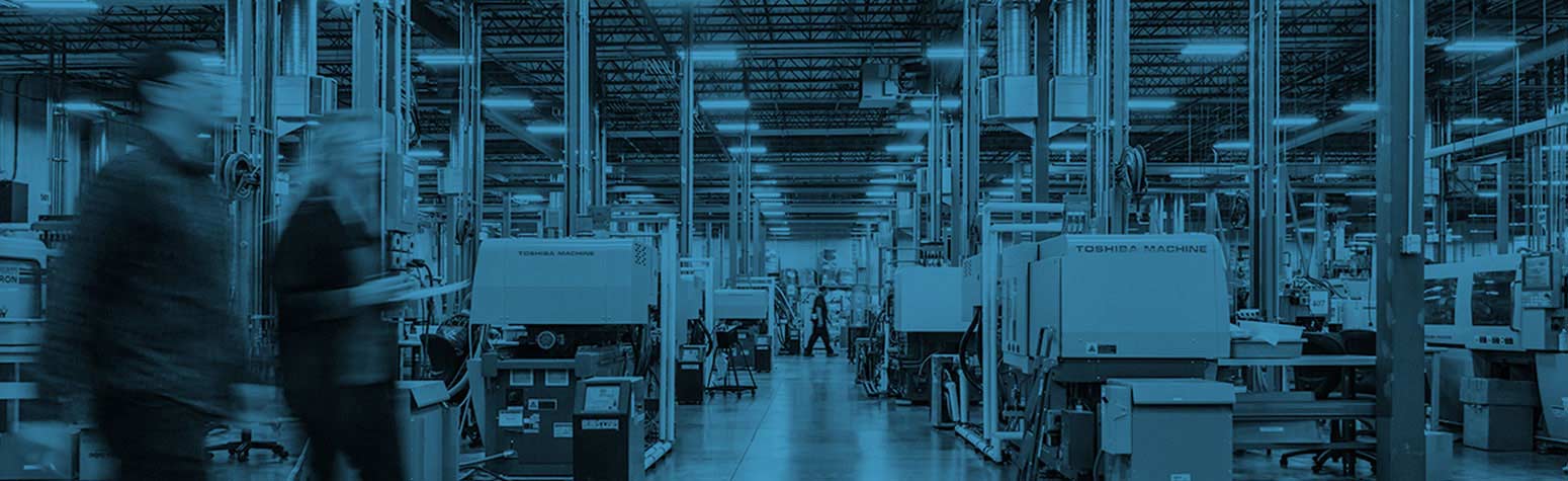

Protolabs does low run injection

Check the sample quote for injection molding at Protolabs. You can order as few as 25 pieces. I have been considering this myself but has not tried it yet.
