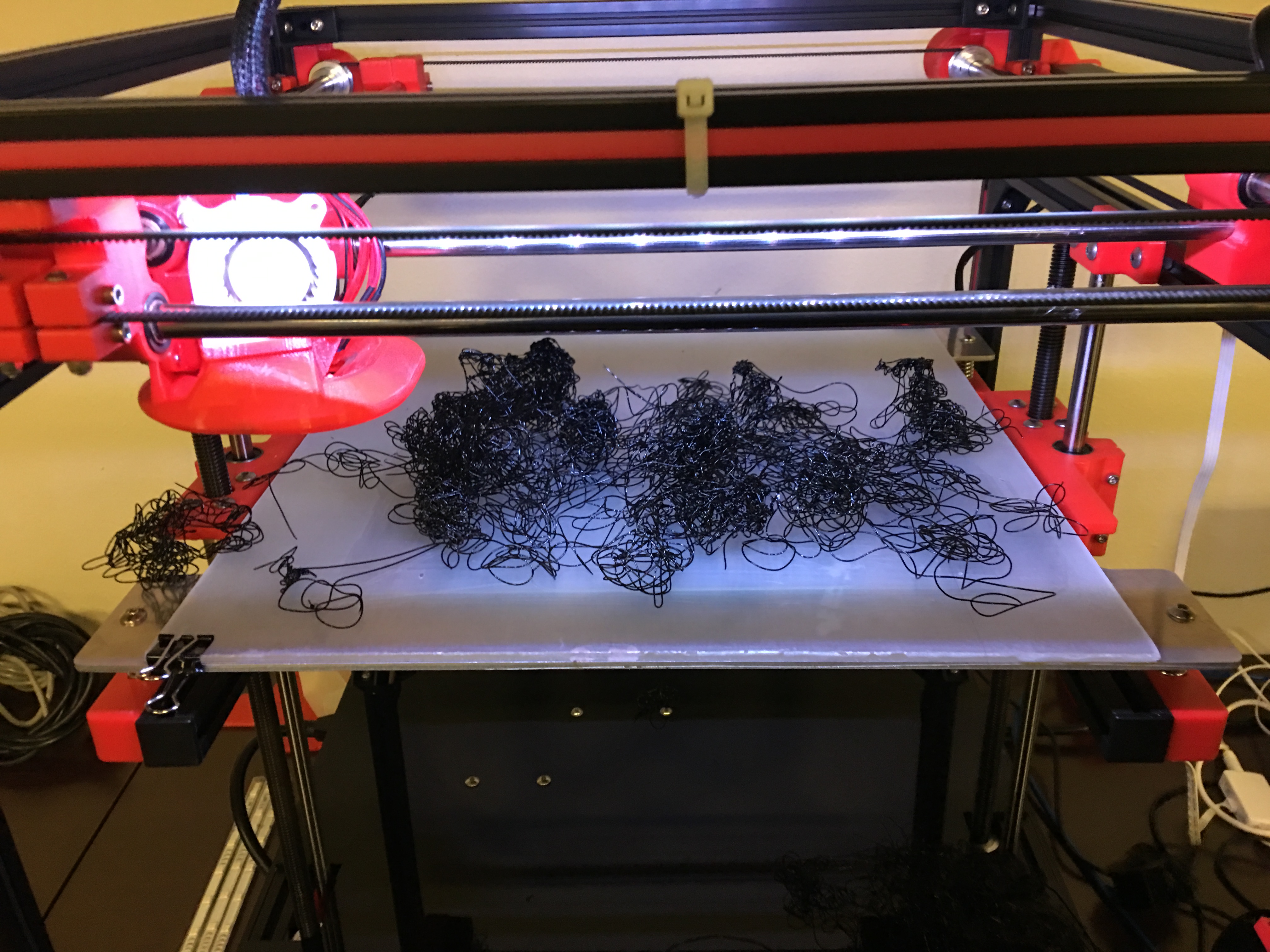

So I came in this morning to find this mess… the rest is on the floor! I guess the adjustable wingnuts holding my plate down on my Eustathios Spider V2 loosened up over time. Lately my prints haven’t been sticking as well as they should. That is fixed now.

That is what is called schrodingers print. Before you got out of bed that print was both perfect and the mess you see. would have been funny if you where printing a cat.
