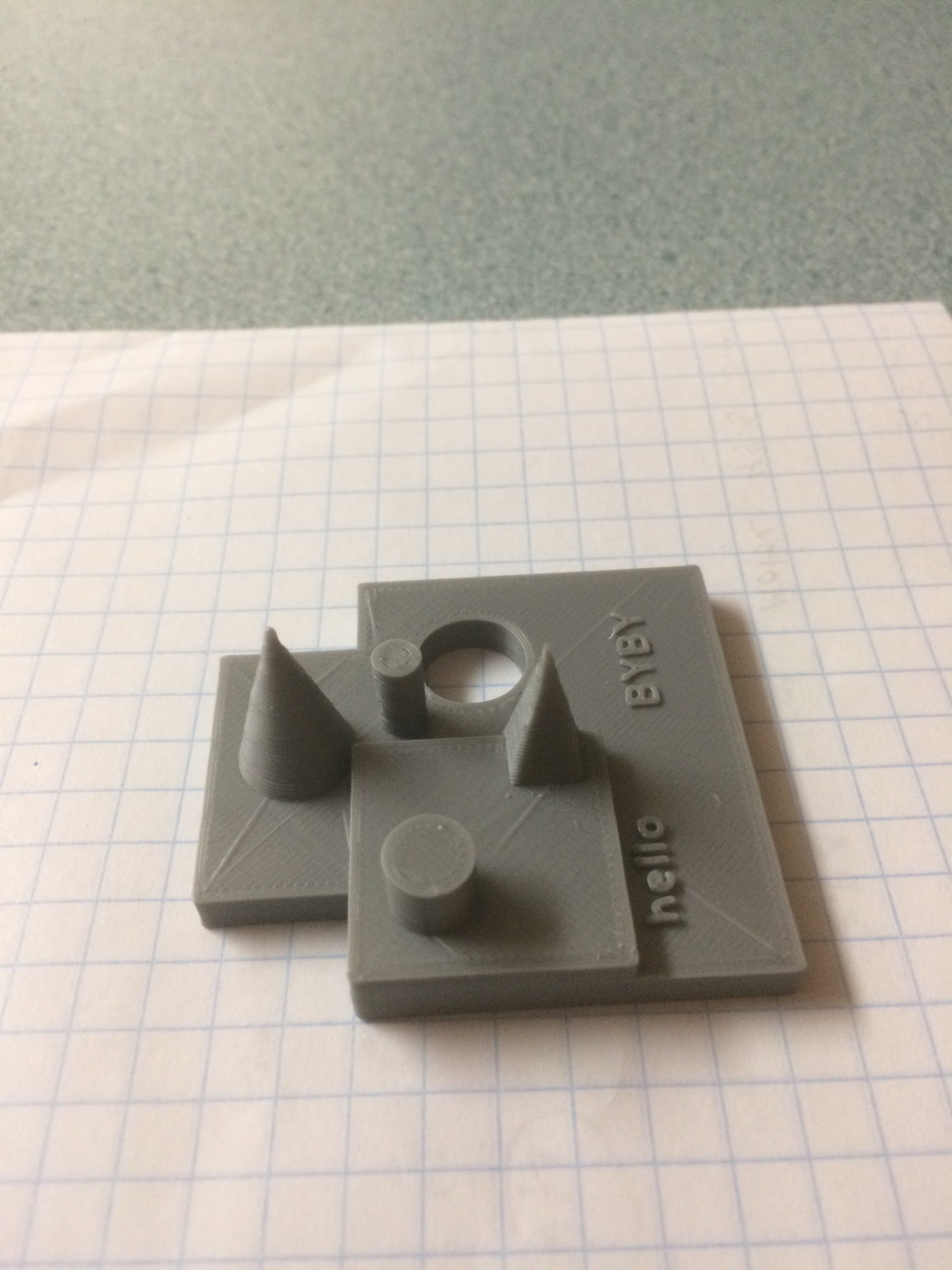

So I decided to build a 3D printer.
So I decided to build a 3D printer. It took 5 months but got it done. Not to bad of print quality.
Took awhile to get all the little strings gone but figured it out.
Hi, well done! Looks really good. Can you say something more about your setup, parts, cost etc…
Well my setup is one that I though of as I look at all the other printers out there. All my axis are driven by liner screws and M17 steppers. I am using 1.4 ramps and Marlin Firmware also a heated bed that I run at 80c. the above test are ABS. The frame is 20/20. the cost I would not guess at it was most likely around $600. this printer is not fast I wanted my prints to look good so it is slow. There are some more adjustments I will do but nothing for speed.
