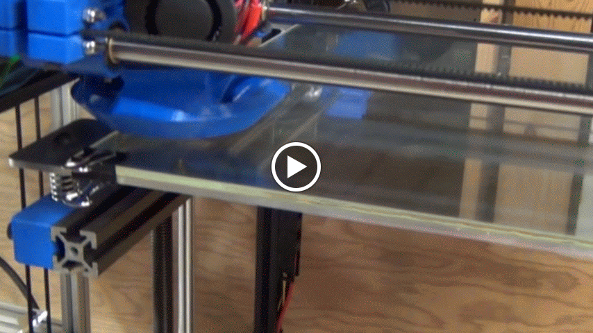

So, I finally gave my spool PETG a shot today (eSun, natural), and it’s driving me mad. I’m having the exact same problem I was having with PLA a while back, and I can’t seem to figure out how to fix it. (In fact, I’m not even sure how/if I fixed it when I was running PLA.)
Anyway, since I suck at describing what happens, I decided to record a video instead. Of course, I’m printing a Benchy Boat, which is everyone’s go-to torture-test object. You can see that large globs appear in the first layer when it’s printing the test, almost as if the extruder is pushing out too much plastic. I put my fingers on the filament as it enters the extruder to feel what’s happening to the filiment, and it certainly feels like it suddenly pushes out a lot more than it retracted just before. at also sounds and feels like it’s slipping, skipping steps, or grinding. You can hear it in the video.
If anyone would be so kind as to look though my settings and find any areas I could improve, that would be fantastic. I’m using a brand-new Bondtech QR extruder, which I have calibrated using the filiment measuring technique and confirmed with the thin-wall cube test. The settings are based on the ones found here, though admittedly, those are not for an Eustathios. http://forum.makergear.com/viewtopic.php?f=11&t=2593
I’m also printing on plain glass as I still need to get some hairspray, and gluestick just didn’t seem to be working. The part would actually move around on the bed, which was really annoying.
The other issue is temperature (second video). When I have the fan going, I can’t get the hotend to maintain temperature. I have it set for 250 for the first layer, and 245 for the rest. However, the temp will drop to about 230 when layer 1 is done. It also barely maintains 250. I’ve run PID autotune, and I’ve increased the proportional and tripped the integral values. doesn’t help much. However, because I get the correct temperature on the first layer, when the globbing happens, I don’t think this is the issue, though I think it will be an issue down the road.

In terms of the extruder not holding the temperature I had the same problem with both of my E3DV6. The heat cartridges were just too weak and delivering less power than specified.
I tested them by hooking them up directly with my PSU (i.e. full power), turning the fan on and they wouldn’t get above 220-230 degrees.
Check the resistance of the heat cartridge - mine was higher than it should have been. I complained with E3D and they sent me new ones straight away. In the end I went for a higher wattage heater cartridge from AliExpress - the PWM takes care of that. No issues ever since.

First layer looks too close to the bed. From what I can tell that isn’t 0.25mm. Also take the time to tune a single wall cube to get the extrusion multiplier. PETG tends to have die swell, and benefits for being slightly under extruded more than over extruded (since it tends to ball up on the nozzle).
Also my temps that works great is 70C bed, 260C hot end. If you are having trouble maintaining temp try PID tuning, or a 40W cartridge since the 25W supplied by E3D is insufficient IMHO.
I have the 40W heater cartage from E3D. I did PID autotune and it wasn’t sufficient to maintain temps once the fan turned on. Is there an M command to just check to make sure the firmware has the right PID values?

I think something must be off, with a 40 watt heater I can easily reach 290 C and maintain it. Also with PETG you don’t really need the cooling fan, trying to run it without part cooling and see if that helps you maintain temp.
So, here’s the thing. I can’t get my heater up to 260 with the fan on and the z axis at zero. There’s too much cooling happening right there, and the cool air just builds up. Damn it, Eric, your cooling duct is just too good
I’ve noticed the nozzle gets noticeably closer to the bed when heated, so I’m going to have to level it with things heated up.
I’m going to proceed without active cooling. Hopefully the cool ambient temperature will do what the cooling would do otherwise.
Not sure what the proper way to test the heater cartage resistance and voltage is, so I just unplugged the powerpole connectors I’m using and stuck the multimeter ends in there. The resistance is 20 ohms, and the voltage is 24.2. The voltage is right, but the resistance isn’t. I’m sure I ordered the right one. Well, this is annoying. Now I have to take the damn thing apart…
The heater cartage is red, so it should be a 40W heater. I have another old heater carriage that’s only 5 ohms, but that might be too low for what I’m doing.
Yup, i know. I just didn’t know I had a bad heater cartridge.
I’m still having issues with the extrusion of the first layer. I corrected the layer height so It’s barely putting it down. I’m still getting the globbies. I feel the plastic going into the extruder and it’s obvious it’s extruding a lot more than it just retracted. It’s grinding and skipping, and there’s white plastic in the extruder teeth. I’m just about ready to throw this damn thing at the wall.

I’ve played around a bit more with my settings. Plain glass isn’t working so well for adhesion (I was really hoping it would, but I kinda expected it wouldn’t) and blue tape was even worse, so I’m going to get some hairspray or give the gluestick another go. I think I figured out the globbing/over-extrusion issue. I had “retract on wipe” enabled in the advanced tab. In the case of the Benchy boat, there are some really small features on that first layer, and I think it had to make a really quick wipe movement and it didn’t retract as much as it thought, and then extruded a whole bunch. Once I disabled this setting, I didn’t get globs, though other issues persisted. If anyone wants to give this a go themselves with my settings, please let me know how it turns out and if you get the same results. I’m thinking it might be a bug in S3D.
