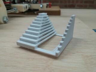

So I fixed the severe underextrusion, and I reprinted the test piece.
So I fixed the severe underextrusion, and I reprinted the test piece. Any suggestions?

That print looks a lot better from what I can see. Are you using a part cooling fan?
