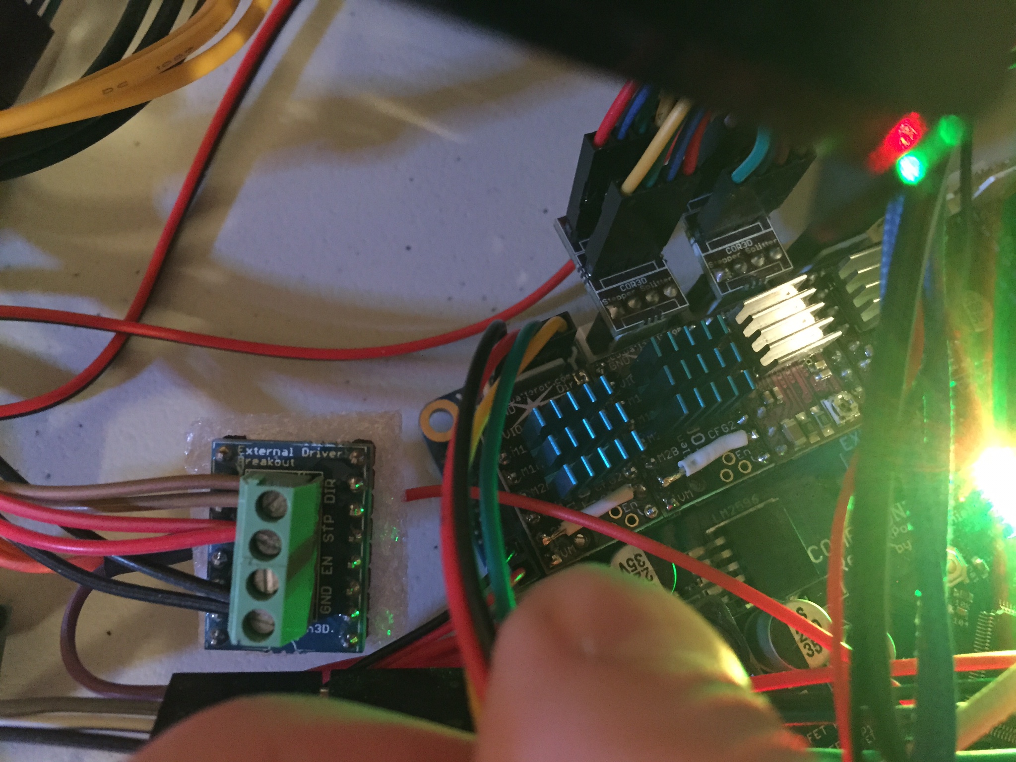

@rubin_kingma They appear to be. I received them in the mail today. They are the step stick you would get if you ordered straight from Watterort (sp?). They do come with the pin headers loose in the bags so you just have to solder the pin headers to the boards. You will also need to order some heatsinks if you dont already have some.
There they are, in the X and Y
