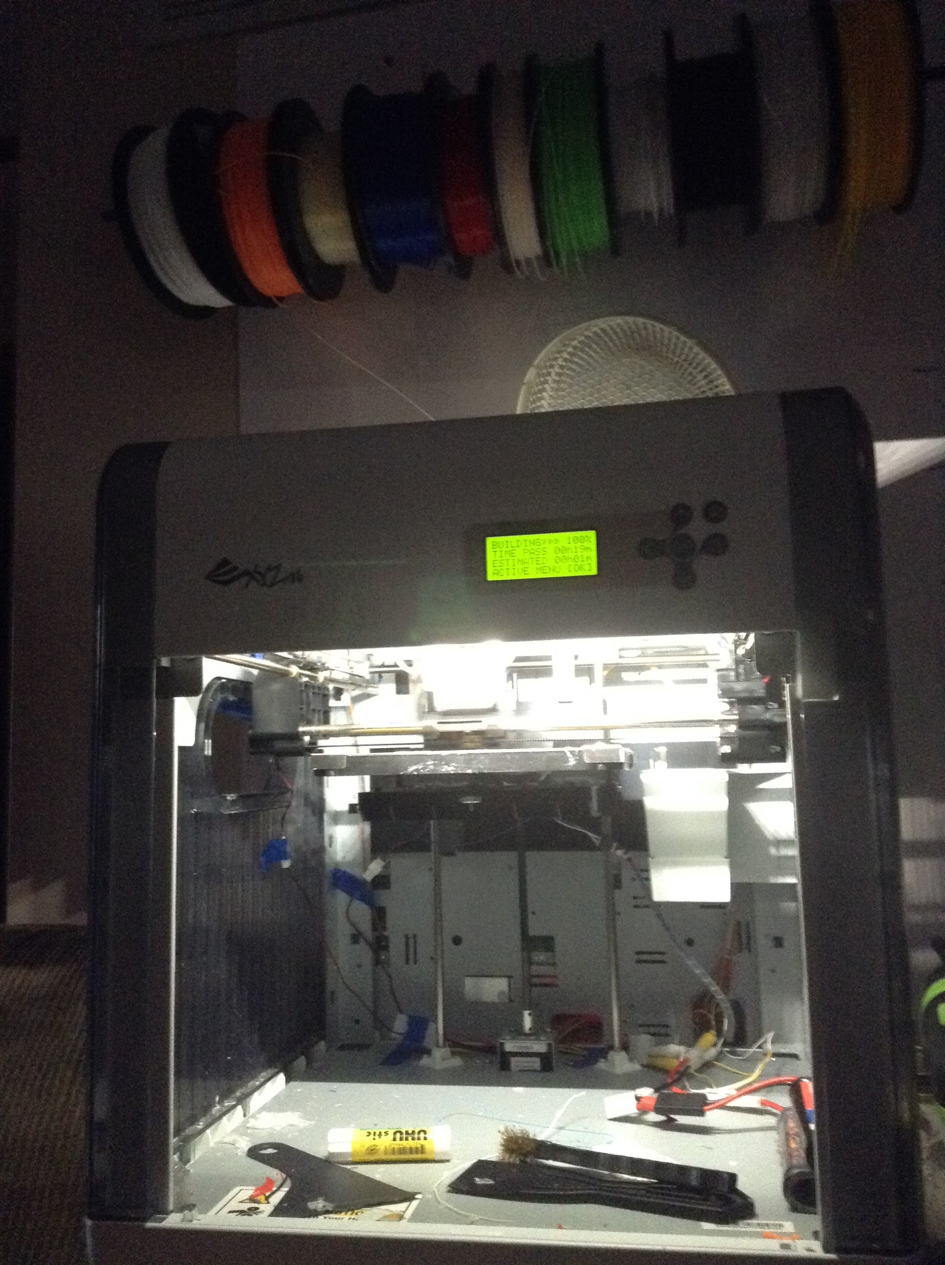

So… I have a filament rack i designed to go above my printer. Ive heard that pla will absorb water and become hard to print. Is this true? How long does it normally take to “ruin or dampen” a roll of filament? Oh and by the way… Davinci printers are a beast. Other than changing a connector, i have had 500 hours of printing and just now had to replace the hotend. I have it all tuned up and the quality is comparable to a makerbot

Re plastic absorbing water, it does and depends on your humidity. This is one nice feature of the stock cartridges. They’re sealed and include dessicant to keep the plastic dry. another way to deal with it is to put it in a oven on low or build a box with light bulbs to heat it up gently but repeated cycles can damage the plastic.

There are some elegant ways how to fight with moisture like http://makezine.com/2015/05/29/keep-pla-filament-airtight/
Just get an e3d. Never breaks, handles everything perfectly. Replace nozzle every 500 to 1000. Having to get a new hot end every 500 is crazy
I used a 5Ltr cake storage box for some time now, keeps the moisture away nicely.
