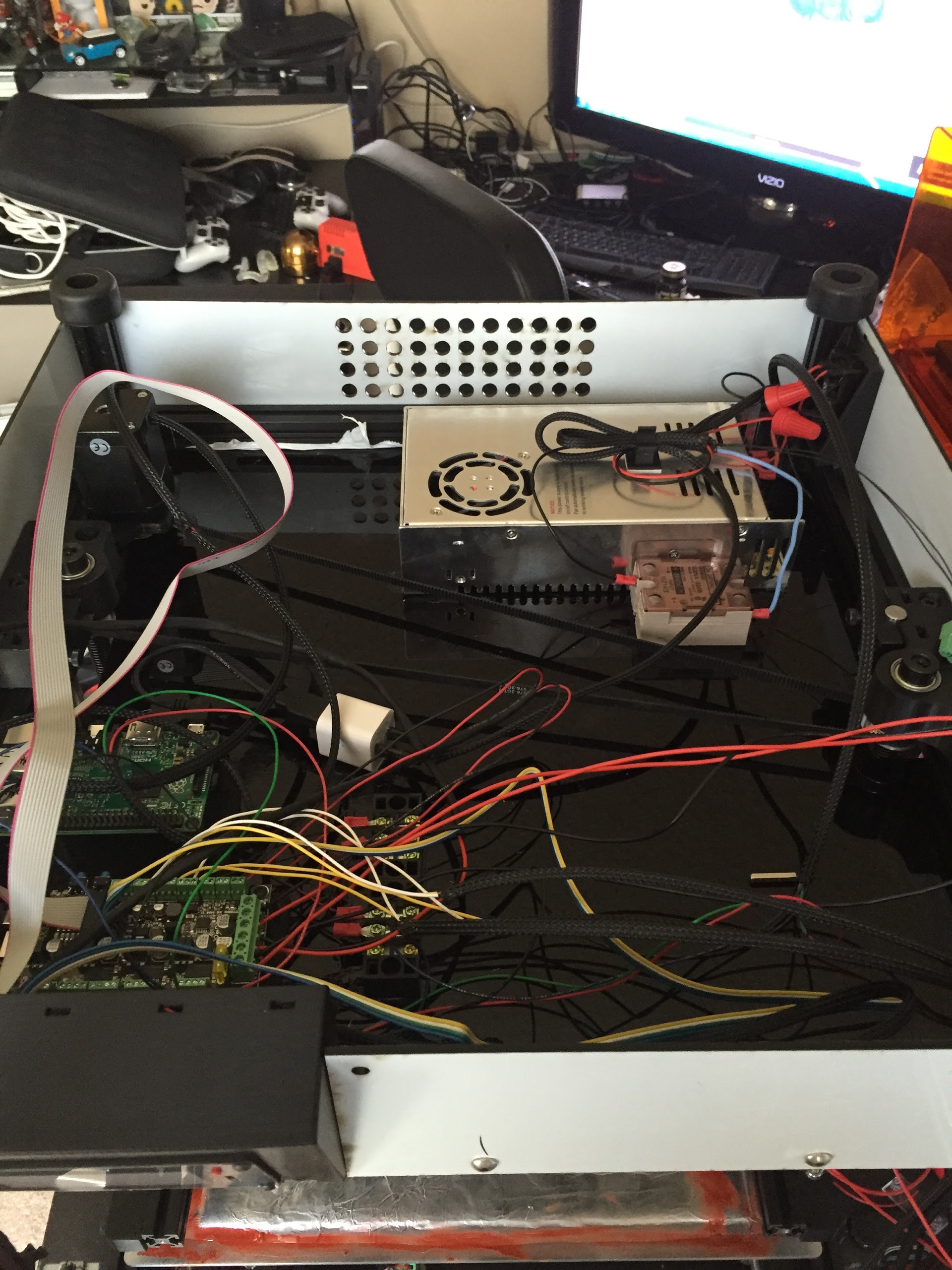

So I have basically everything wired up to what I believe is correct. If anyone has a diagram for wiring please share it. Specifically how to wire the relay and the plug. Last thing I want is to fry everything. Also I still plan to clean it up.
Nice job, I’m gonna work on my printer today.
Hmm that looks different then how I have wired in the past
@Derek_Schuetz , @Walter_Hsiao is correct. Your normal bed output on your printer controller is hooked up to 3 and 4 on the SSR (3 is positive, 4 is negative). Then mains live power is run into and out of the SSR (into 1, out of 2). Then power travels through the bed and back to neutral.
The SSR acts as a switch breaking the live connection. Just think of hooking the bed direct to the mains (it would be always on). Now instead insert a switch on the live side to allow the circuit to be powered intermittently via input from the normal bed output acting to drive that switch.
