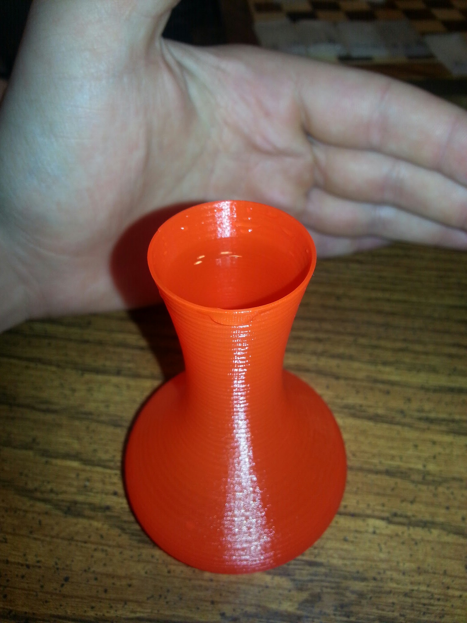

So I have owned a printrbot simple for almost a month now and I thought I would do a brief review. Pictures included.

Print quality: fine. I have printed mostly arty .2 mm only a few prints at .1 mm, but I have no issues with anything I have tried. I have not tried spanning yet.
Overall impressions: it is fine as a first printer. After owning it I do want a larger build area (200 mm cube would work I think), but I do like this product on the whole. It is cheap and I have had only 5 prints fail after the first layer (tilt or turn into the saddest spaghetti monster).
