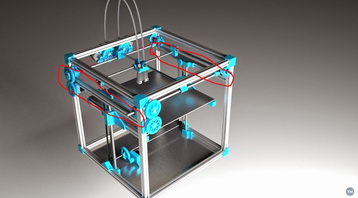

So i have the frame built. Just the outer cube though. I’m getting in the last parts to fix my mendel, so I can finish printing out the rest of the parts. In the meantime I was wondering how far down these extrusions need to be placed and how large should I make the bed? Thanks!
Not sure bout the Ingentis, but on the Eustathios, it’s 20 mm from the bottom of the top extrusion to the top of the bottom bearing holder. That’s a bit confusing, so I made a pic for you: http://imgur.com/G74pCPU
Eric Lien also made some printable alignment things that work for the Eustathios. Again, can’t be certain about the Ingentis.
Thanks! could someone confirm this so that I don’t go drilling holes in my tslot in the wrong spot?
