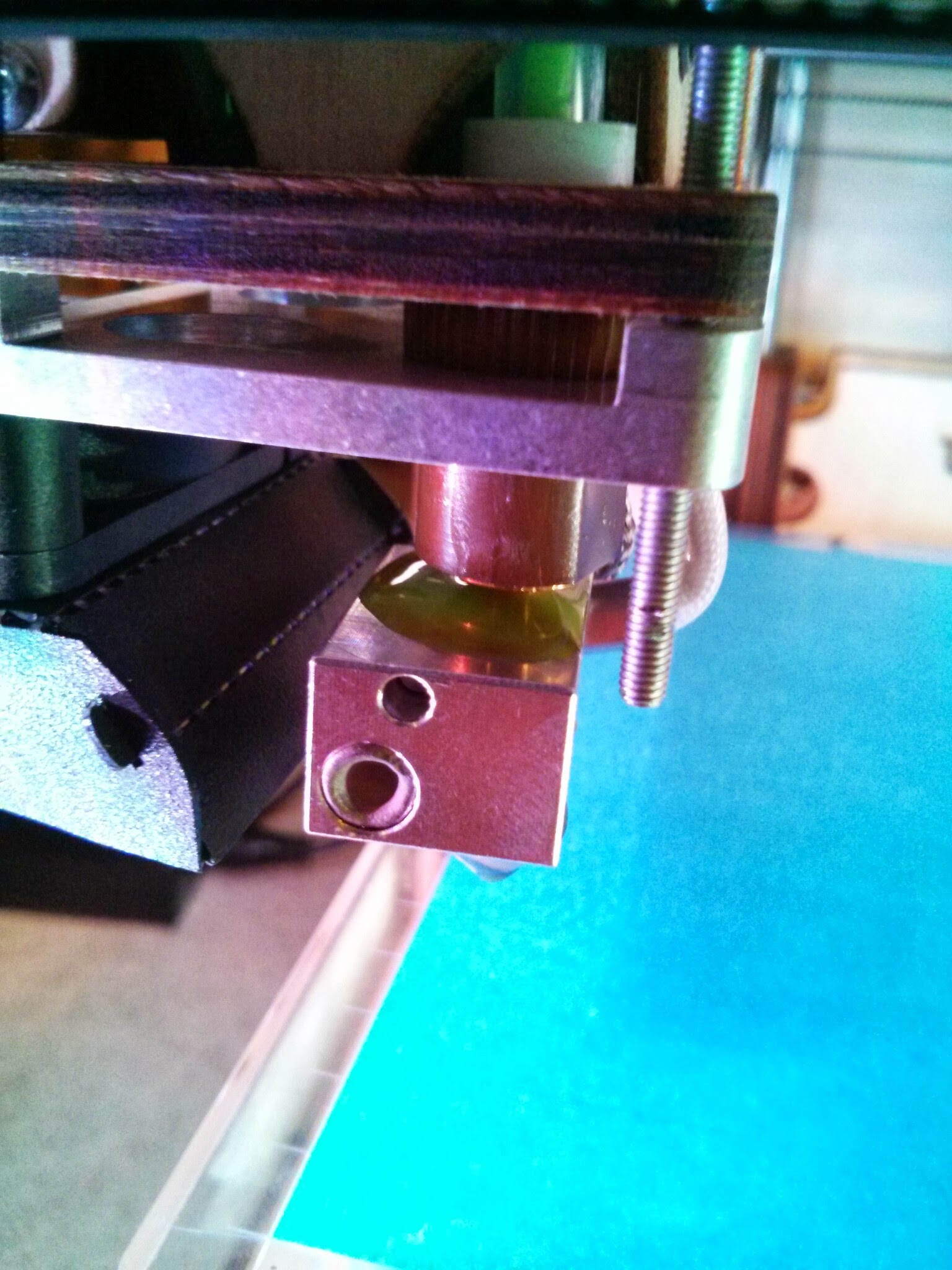

So I just assembled my new Ultimaker today and did a test print,
So I just assembled my new Ultimaker today and did a test print, I started to notice some of the green plastic leaking out on the hot end, any ideas on how to fix this?
Thanks in advance!

You should have got some PTFE tape with the machine. You wrap a tiny amount around the bottom of the thread between the heater block and the nozzle. Also you need to make sure the heater block is nice and tight against the brown plastic section.

Never needed any tape or sealer on my Stepstruder MK7 and haven’t had any leaks. I make sure I do the final tightening with the hotend heated.
Yeah, it might be a little loose. I bet tightening it will fix it.
Try tightening while it’s hot. I got melted pla in the threads of my hot end. It won’t tighten very much at all anymore until it’s at extruding temperature because the plastic is blocking the threads. I removed the plug from the hot end, heated it without filament in it, and very carefully tightened the thread. I used a needle nose, but had to use my bare fingers on the peek tube of my hot end. Good luck
