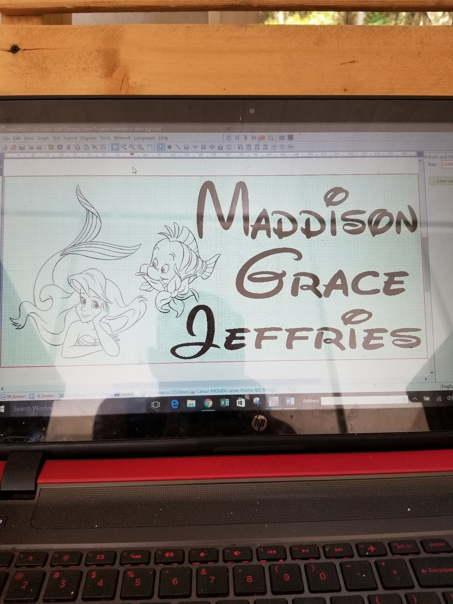

I am engraving this for my daughter’s room. If I want to basically outline the letters will telling the laser to cut the letters instead of engraving them only have it cut the outside? If so plan on having it cut really fast as not to go all the way through
Thank you for the responses also!!!
Increase the speed and reduce the power level
I call those a ‘kiss cut’ where it burns what it normally be cutting through… usually I run them at 3500mm/s at 1/4 power.
