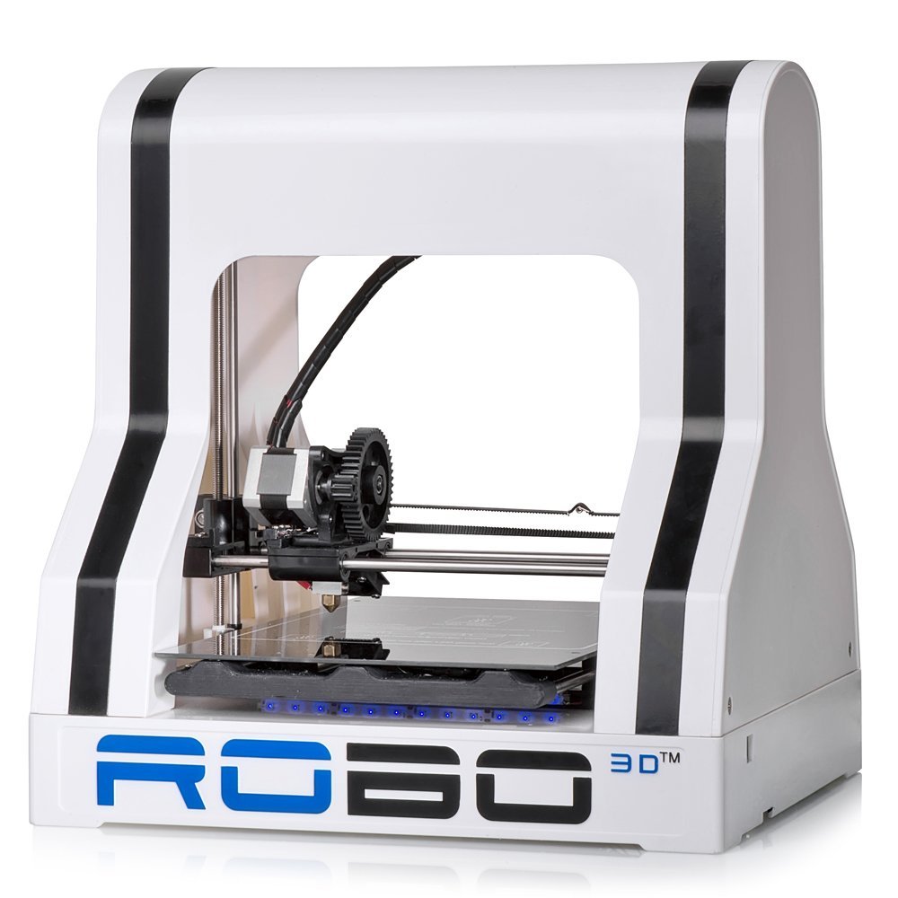

So I just ordered my first 3D printer. My Robo 3D R1 arrives Wednesday.
Any one got some tips for a 3D print noob? Especially from any other Robo 3D owners.

No first hand experience but seems to be a solid printer and @Mike_Kelly_Mike_Make is a great resource here and on the forums.

Note, the new version of this printer uses metric threaded rod. Print a calibration cube. The calibration cube may come out short. It if that is the case, it can be fixed with an m92 command.

Hi Bryan, congratulations on the printer purchase! Camerin is correct and the steps per mm on the Z axis may be off. We just released a new firmware v3 that resolves this issue and some others. I recommend updating your firmware through Matter Control if possible. Other than that just watch our getting started video and you’ll be printing in no time!
