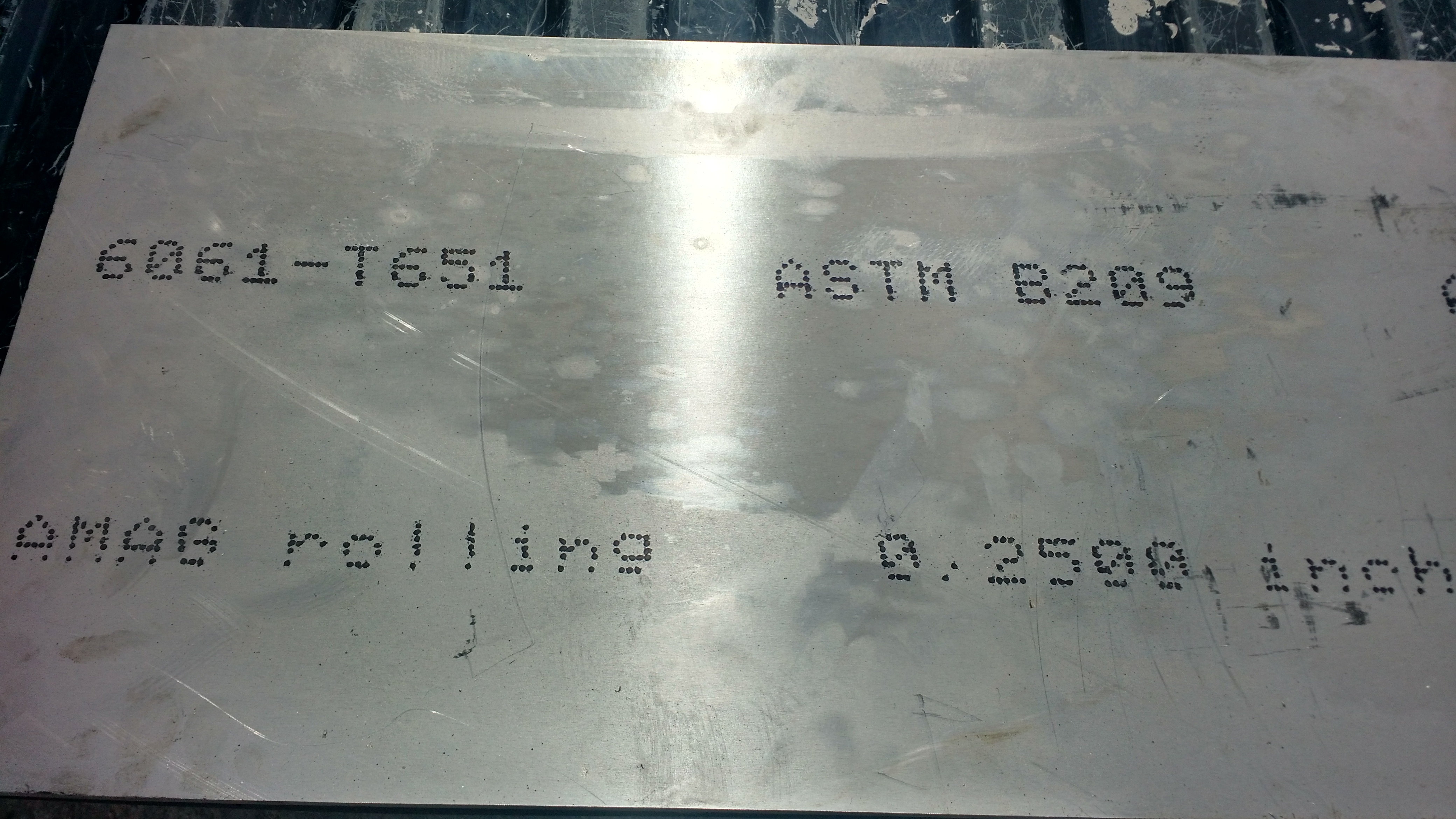

So I just purchased some aluminum to play with once my kit arrives and
So I just purchased some aluminum to play with once my kit arrives and is assembled can anyone tell me if i bought the right stuff – 6061-t651 it was priced at 2.50 a pound (15.75"x32.125"x.250" @ 32$) is that a reasonable price or should I look into other sources?
That looks like the right stuff (or at least popular stuff). $2.50 a pound sounds reasonable to me. Like anything, the more you buy, the cheaper it gets.
Thank you good sir was hoping I hadn’t wasted 32$ for a 15.75" x 32.125" sheet.

That is a good price for the material.
Be sure to buy spare milling bits.
$2.50/lb is a pretty good price for 6061 of that quantity.
