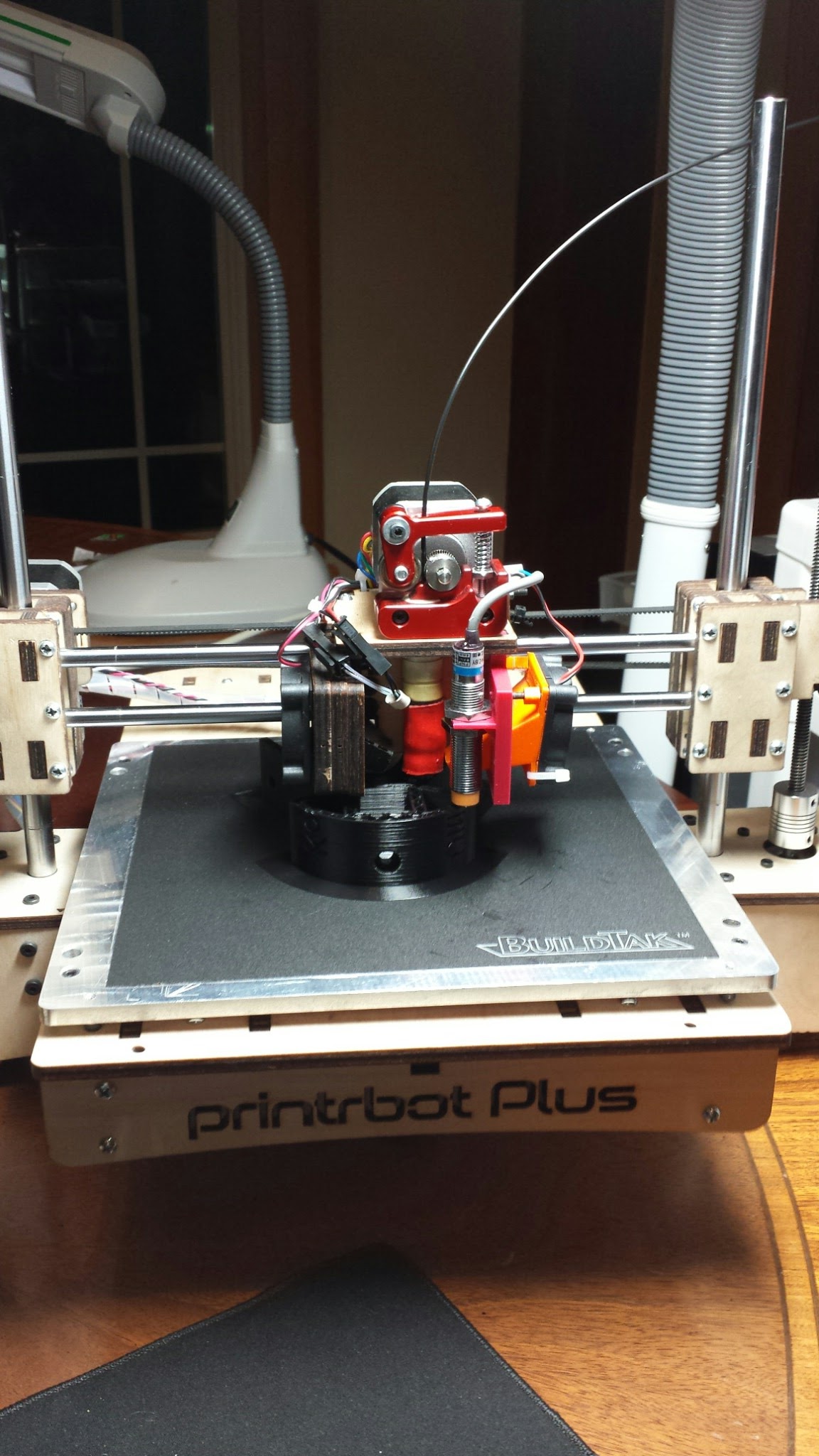

So I just replaced my printerboard with the new Rev. F running the firmware for the latest printrbot plus. The problem I ran in to was the y axis was not homing the right direction so I reversed the plug on the y motor. After that the printer seemed to home fine. The problem I’m running into is all my parts are mirrored. The words are backwards the herringbone is backwards even the print preview on cura is backwards. Please help I’ve been doing this for about a year and encountered a lot of problems but nothing like this. Note the pictures were the words read the right way are taken in the mirror.
You’ve got your endstops/motor direction backwards somewhere.
When you home on a machine like this, the bed should go back (away from you) and the head should move to the left. The nozzle should be at the front left of the bed for 0,0.
Flip whatever endstop, and motor connector around so that this is where it ends up on homing.
@ThantiK Right out of the box X and z were homing corectly. Y axis however was moving toward me to home not away so I reversed the motor connector and everything seemed fine it all homed in the left front corner. The only other new feature I’ve added is the induction sensor which before touches the front left, back left, and back right corner before the print (which to me seems corect). I hope this info helps.
