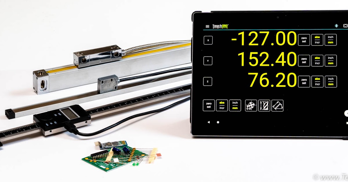

Check out this link. This was done using Arduino or MPS430, Bluetooth, and an Android tablet. I’ve built two of these and they work great.
This is the hookup I did for my lathe:
