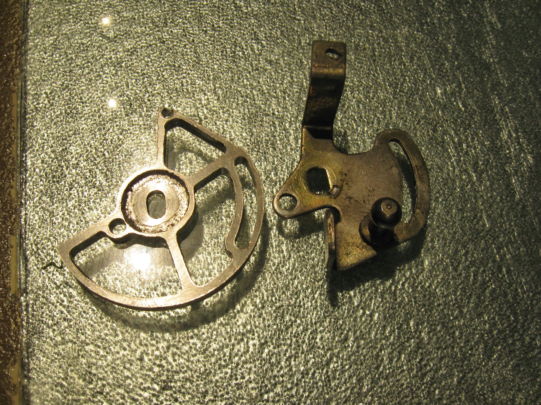

So I make stuff as shown in the large photo (in this case,
So I make stuff as shown in the large photo (in this case, an aluminum carburetor actuator to replace the steel one that doesn’t work right.) It looks okay from the top but when you look at the side, it’s really rough. Partly that’s a worn-out bit, partly it’s that my machine isn’t rugged enough to do the job in a single cut, but what I’d like to do is do an oversize multiple pass, then come back and do a last full-depth pass to the right size. How much should I leave previous to the finishing cut? Should I run a higher spindle speed for finishing? Higher feed rate? I’m using HSS on 6061 mostly, on a Sherline mill.
