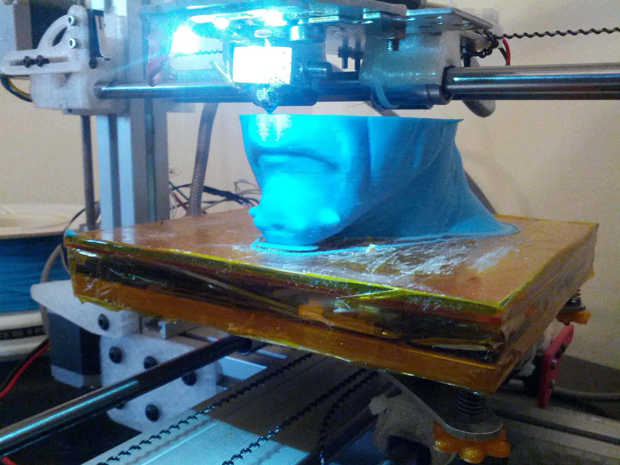

So  I managed to shatter the glass to the HBP by using a bit
So I managed to shatter the glass to the HBP by using a bit too much acetone and a flathead screwdriver (spatula failed really bad.) Oh well, got a sick .15mm glow in the dark devil printout of it :smiley:
Pretty sweet sculpture!
How long did it take to print?
@Casey_Arvin A little over 10 hours with a highspeed .15 layer height setting that skips infill every other layer and does it at .3mm (because who cares about pretty infill?)
Great print. How are you going to finish it?
I’m leaving it as is, haven’t done the acetone steamer on glow in the dark prints yet to know if it melts them too much.
Is that PLA?
Nope, glow in the dark blue ABS from Afinia. Great stuff, but you have to set your retraction up a bit to 1.4 or even 1.6 if you are doing a lot of traveling.
nice and really big, what printer did you use??
Bukobot Mini Green :slight_smile:
