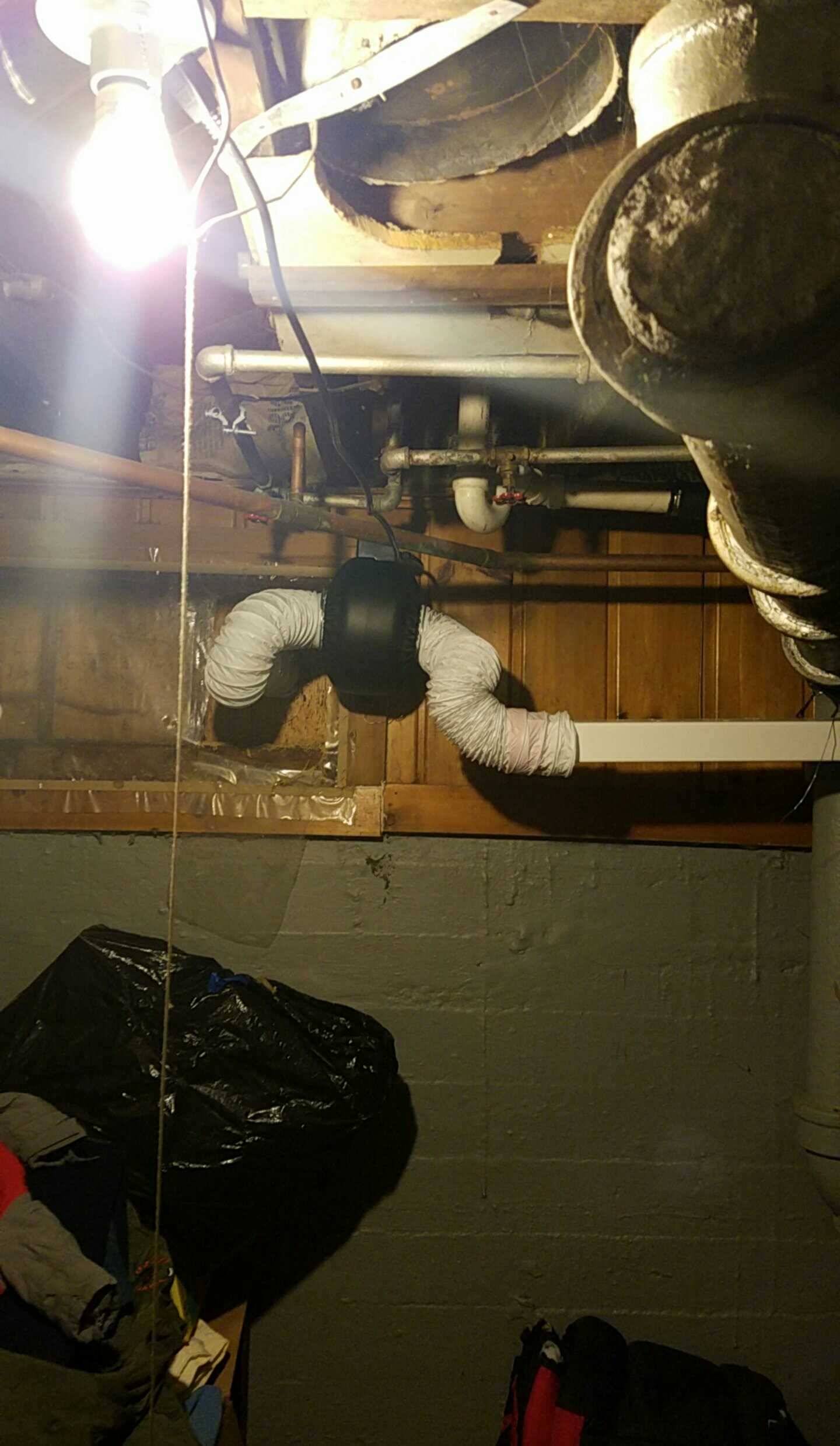

I found part of the issue, I had the exhaust fan at the start of my line, I moved it to the end and the smell went down tons, however in the area the fan it (round 290 cfm inline style, will attach picture) I am catching fumes from acrylic, wood I do not care about, but if I stink the house up my other half will be… angry.
This is the fan I have. I do not have an option for a window in my office so it is ran down tubeing to another room basement window and out a dryer vent I put in.
Yes that is square gutter pipe, but I 3d printed and silicone adapters in so it is super solid.

@Cesar_Tolentino from my understabding that is from abs and not acrylic. And I found the source of my issues, it is cold outside and the wood it is in is not air tight and some air is creaping from the temperature difference outside. Will be fixed later today.
