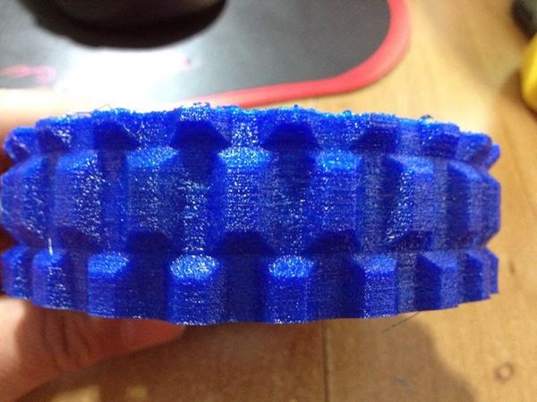

so i printed the honeycomb tire that was posted on the site here but
so i printed the honeycomb tire that was posted on the site here but had a few issues with it. printed at 100% infill
  1. yo ucan see the printer didnt finish the print, it finished while i was sleeping (20 hour print) and the nozel clogged up, the center area for the rim is finished though so it can still be put on the rc car to test out.
  2. the small honeycomb pattern inside the tire is to small to print effectively, there are very tiny gaps in the middle of all the connection points of the honeycomb, they need to be widened up a tiny bit for proper fill.
  3. ha vent tested the tires yet but seems they might be a bit to flexible with how narrow the honeycomb pattern is, it could be widedned up a bit more to also help keep it a bit more rigid
