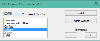

So I put together a VB application for communicating commands to the Arduino for
So I put together a VB application for communicating commands to the Arduino for things like lowering brightness or turning the LEDs on and off, or even selecting a pattern. See my project here: https://github.com/jbud/ArduinoCommunicationApp
I modified the DemoReel example shipped with FastLED so that it would be easier to find what I changed.
Please Note: This does require FastLED 3.1 because that is what DemoReel uses. 3.1 is available on github as a branch

Well, if you compile the application in Visual Studio, then you’ll get an exe file you can launch. Use the Arduino IDE to upload the program (DemoReel100.ino) in the ScriptForArduino folder. Please note that the app does not automatically populate with the available patterns and are hard-coded, however you may edit the code if you please. Consider it a standard open gnu project, you may use my code, but don’t sell it please.
Be sure to edit the DemoReel100.ino file to have the correct headers for your LEDs, and be sure you have FastLED library in your arduino at least version 3.1
