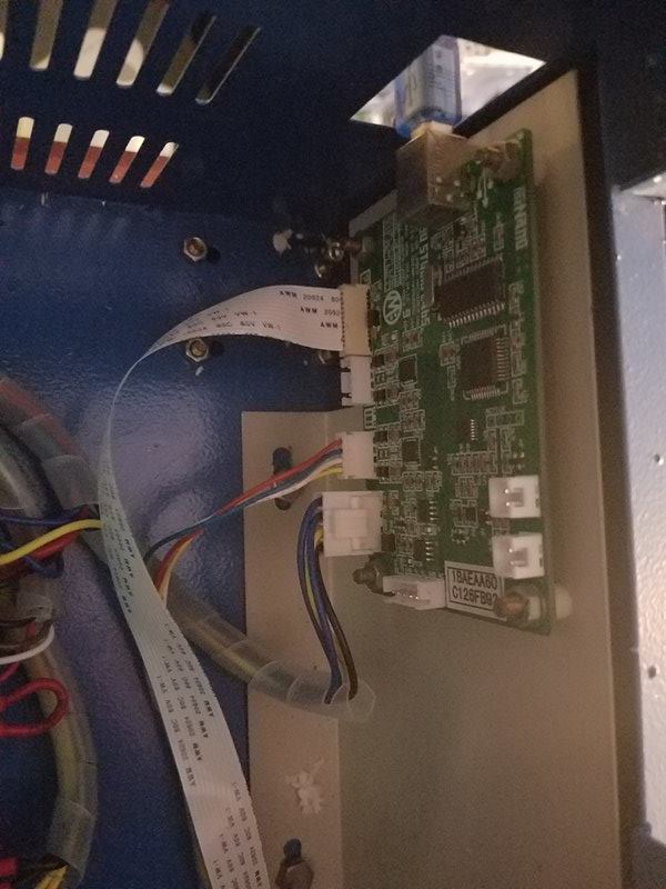

So I recently got a k40 laser cutter off of ebay and notice it is a lot different then the ones people are using on here. I am interested in using a smoothie board, however my cables are very much different. I have one ribbon cable coming in for a limit switch and the stepper motor on the left, and a normal cord for the stepper motor at the bottom. Will that create an issue when getting the board? Also Should I order an unpopulated board?
You have one of the two fairly new board types. As you see this uses a ribbon so to use Smoothie you would need to splice that with what is called a middleman board. I would recommend you talk to @Scott_Marshall as he sells a kit that will take that and give you a easy connection to a smoothieboard that he also sells. This is the easiest path available.
Looks like mine (it’s a Nano board). No worries upgrading to Smoothie.
ks for the feedback all, will look into a middle man board. Plan to get an updated nozzle and new lens for said nozzle soon. Then I will be looking into doing the smoothie upgrade.
