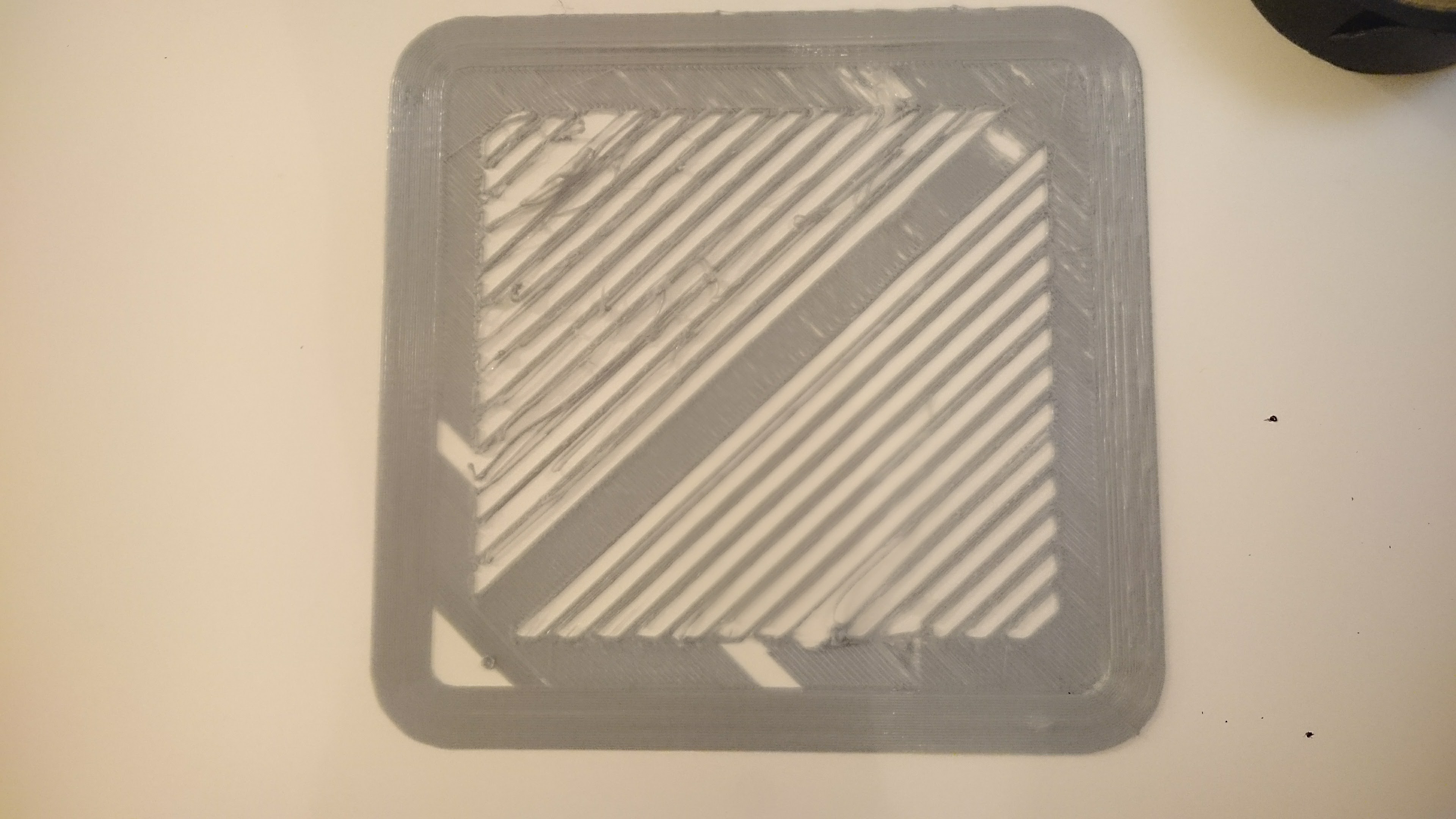

So i started printing a mainboard cover for my anet a8.
So i started printing a mainboard cover for my anet a8. Do you know what went wrong?
Can you provide us with more settings? Print speed, temp, filament type, etc
Here you go:)
Try speed about 35 mm/s. 60 mm/s is too fast for Prusa.
Agreed. Make sure your first layer is very slow. I believe mine is 20-25mm/s
@Griffin_Paquette how do I adjust only the first layer?
Although slowing down for the first layer could help here I disagree that 60mm is too fast for a Prusa. I generally print 60-70mm with ABS and PLA. First layer I print at 30mm.
Choose “Preferences - Settings” : Right colum check “Initial Layer Speed”. From now on, you can adjust the initial Layer speed.
@Mindless it is cura. It maybe looks different because im on a mac
Could it be also the printer bed? Last time I removed a print the duct tape has torn. So i used some painters tape which has another texture…
I’ve ordered this print surface. Hopefully it will come next week
@Jonas_G I would highly recommend that you get a sheet of PEI. Better for printing in my opinion
