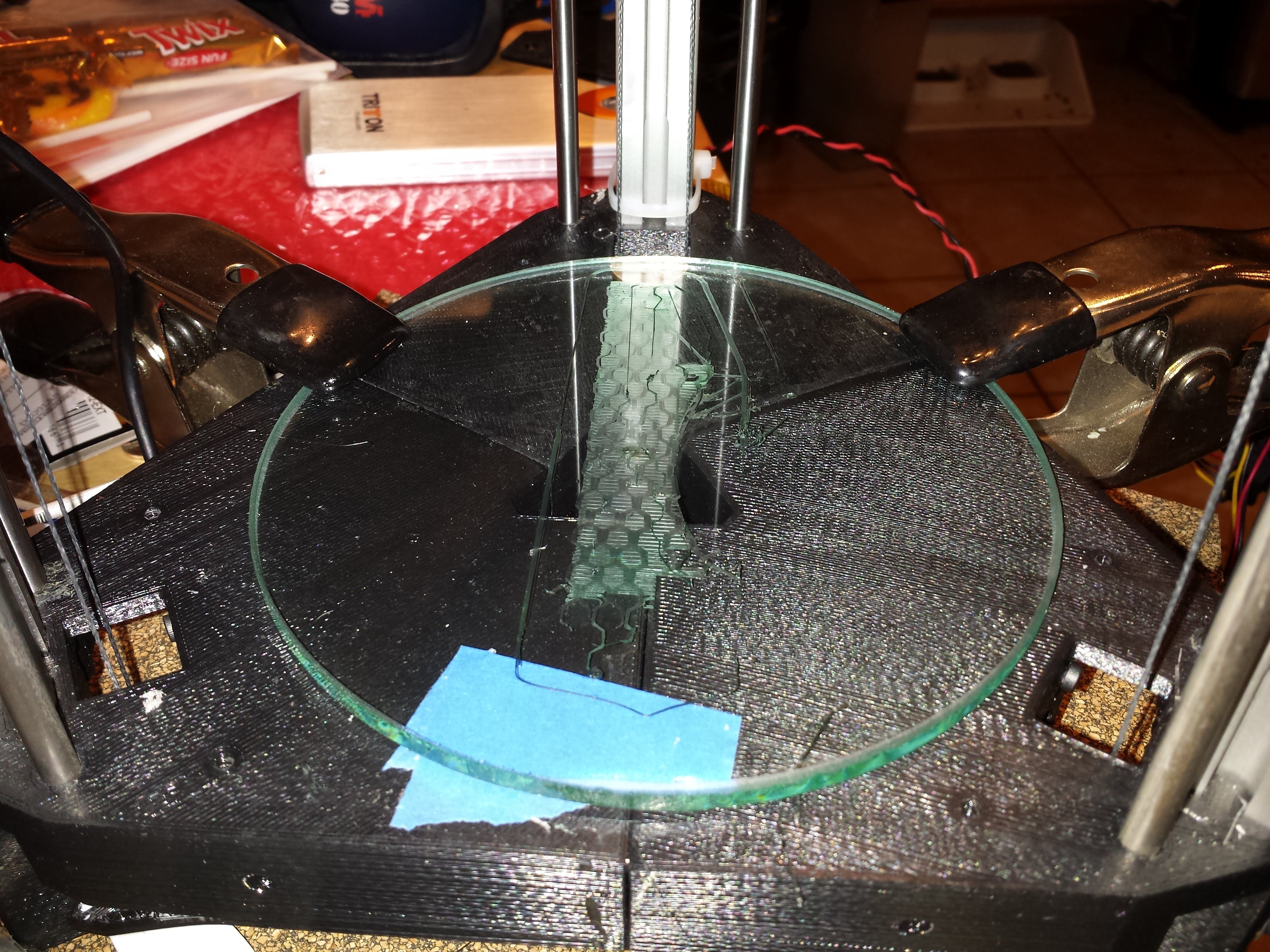

So…I switched to ABS and Aquanet on the Glass bed. I’m EXCEPTIONALLY happy with the first layer or two it lays down. :slight_smile: I expect my feeding problems will be greatly improved when I get real screws applying pressure on the filament feeder (currently using zip-ties as M3x30mm aren’t available locally)
A test print of the mount for the LCD panel shows that 80% of the build surface is being reached and covered (not perfect, but surprisingly good)…but I’m hitting my head on MAXTEMP (255) which has the print failing poorly. The print temp is set at 245, but there’s some hysteresis and it appears to be touching 255.
