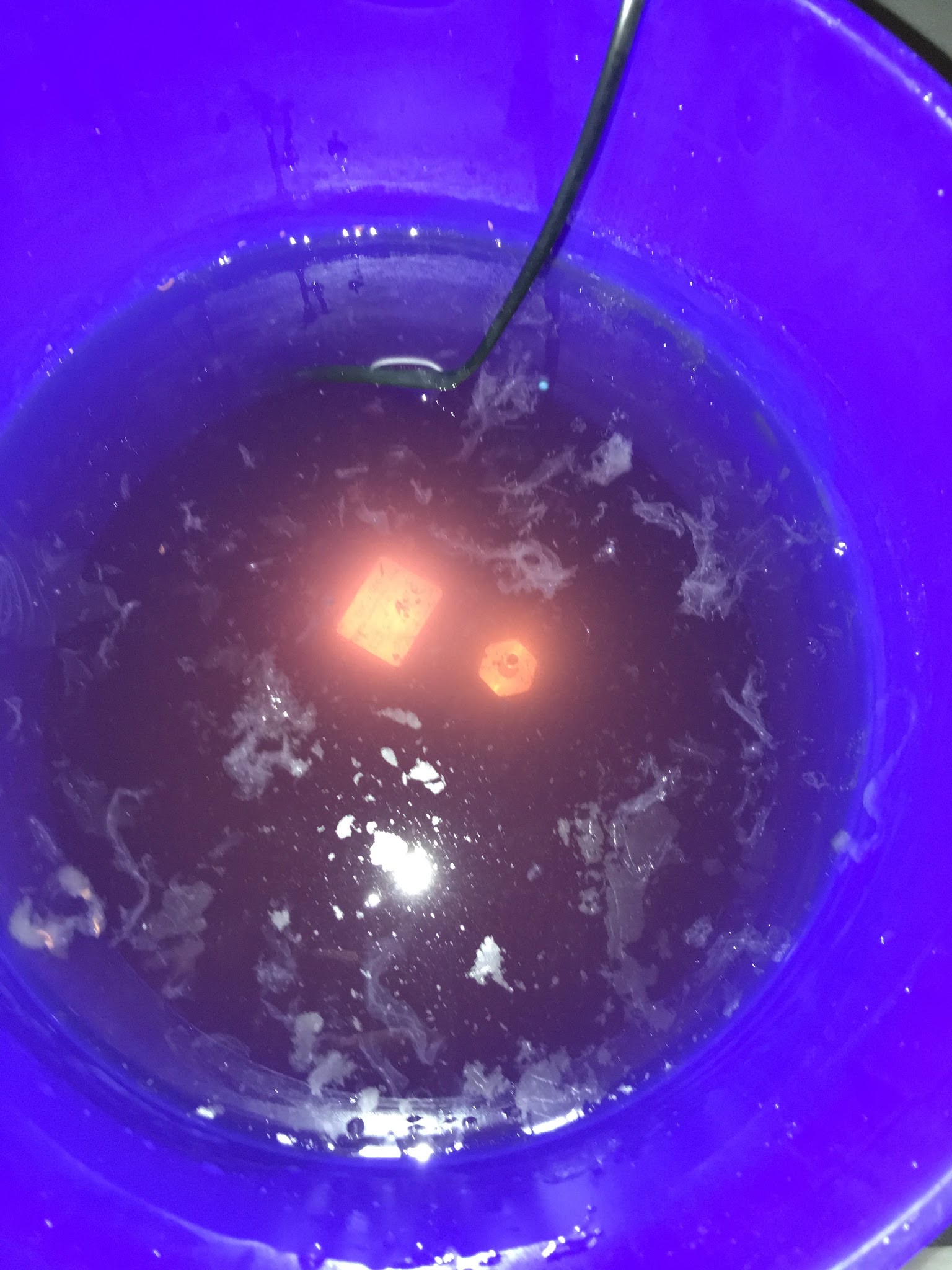

So I take it this isn't good when I open up my water take
So I take it this isn’t good when I open up my water take and see this
Yeah looks like some kind of algal growth or mould? Whatever it is doesn’t look good. I imagine that might be where that brown ring on your tube comes from (some of that algae/mould getting into the tube & heating up/sticking to the side).

@3D_Laser Personally, I am not sure. However I can’t imagine it is good for the tube to have residual buildup of algae/mould inside it, as this possibly increases heat in that region (which may eventually weaken/destroy the glass in that section). Also, it could eventually cause a full blockage/issues with water flow through the tube, again causing excess heat. Hopefully someone with more experience can share their knowledge with you (and me too).

I have RV antifreeze in there. right now I dont see any cracks in my tube but i can’t get it fire. I think its my power supply the tube seems intact but I am not for sure
Well it shouldn’t be algae then. To be honest, although it’s hard to tell just by looking at a pic, it looks like tissue to me.

I have seen similar stuff in my watercooled pc´s due to hoses making a oily surface.
Also got this on my new laser, only run about 20min so i removed all hoses and cleaned them good.
Now 3hrs more runtime it´s gone.
Touch the hose from the laser, is it oily on the outside?
Your´s a magnutude more in amount that i got though.
