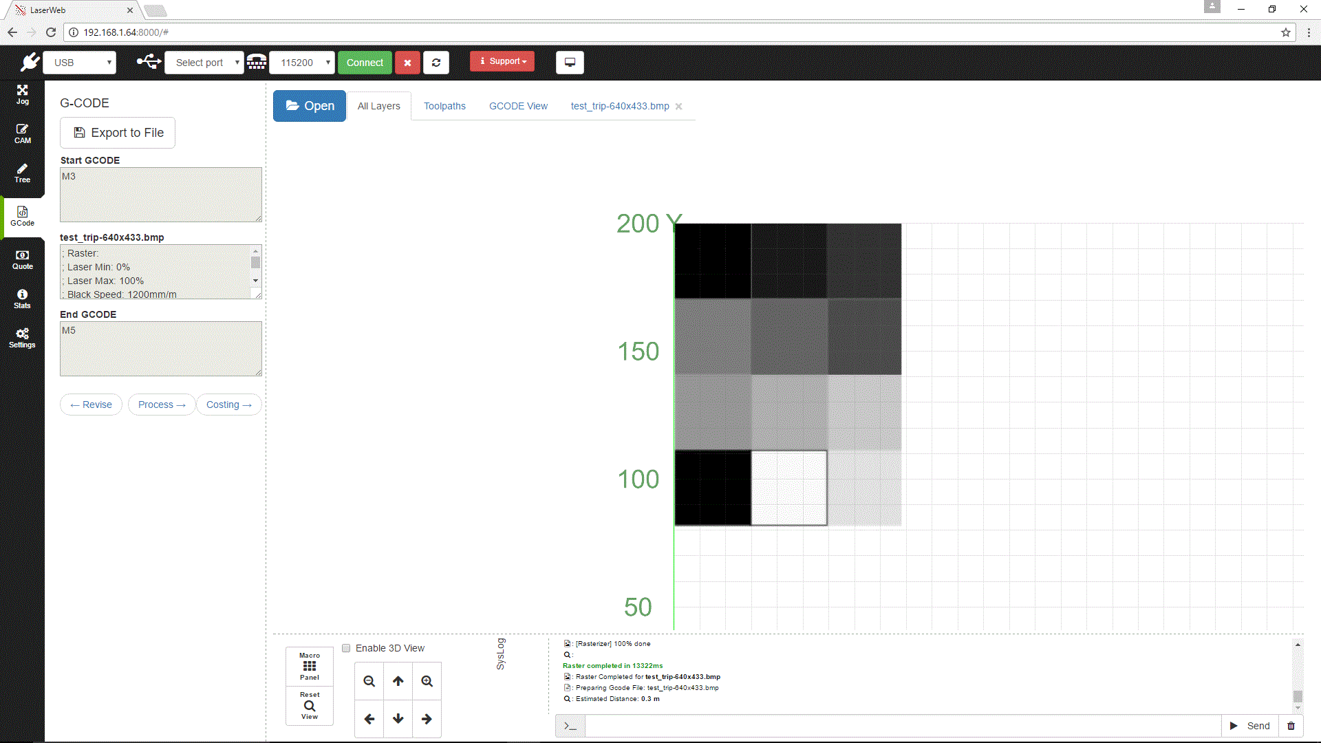

So I updated to the latest version of laser web and was going to do a grey scale test. Every time I generate code it makes one path down the right and that is it. Very odd.
Have tried it in a few file formats as well.
Update have adjusted Concatenate Raster X Moves either witch way and same result.

Hmm, still doing it. Will try uninstalling everything laserweb and starting from scratch.
Super stumped, deleted everything, cleared all data in Chrome re installed (got it working first time too this time
) And same thing. How crazy, will try other files now.
So tried doing a couple things, a cut and a file to raster. it set up a cut fine, absolutely will not raster an image.
Indeed! it takes it a while to do the job, it is not instant, but when it finishes and you would expect it to dump the paths, it is just one line down the left side, regardless of what file I put in there. I have no tried with the exe, and the long install, after clearing all data off. So now I am wondering if python is used in the generation? maybe my python install got funky?
Oh hey it worked out alright with the power adjusted to one. Makes me sad though really liked having a buffer set, will have to look into the suggestion from Ray to set a cap in my Smoothie Config. Sorry such a simple item was such a nuisance to you +Peter van der Walt, though if I could suggest a feature having the ability to put a soft-cap into laser web would be an amazing feature for everyone to safe guard the tubes, and I cross my fingers for color recognition for cuts/raster.
