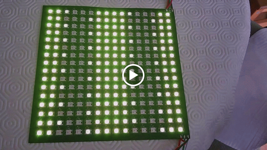

So, I was just messing about with my 16x16 matrix, and thought, hey, what about bitmaps.
How would I go about pushing sprites out to the matrix using fast led?
I’m thinking pacman cherries, donkey Kong marios and space invader type 8bit sprites.

I have written XY Matrix, Text & Sprite classes that work with FastLED. They can be found at https://github.com/AaronLiddiment/RGBLEDS
Also if you click on my name heading to get my profile, you can see some example videos.
