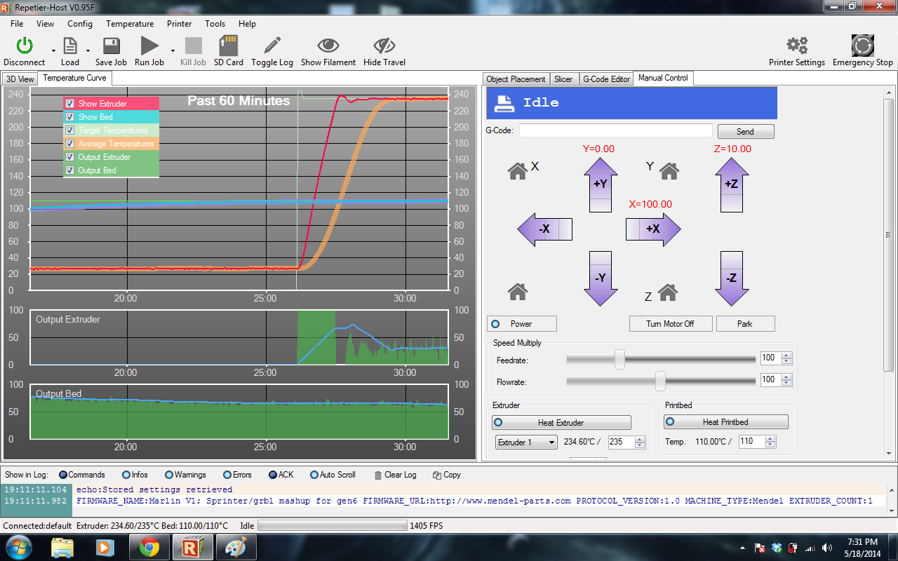

So I was looking at my temperture graph and I noticed that my hot bed reduces it load as it gets closer to the expected temp as seen in the picture. It takes a very long time for my bed to heat up like 30 mins. going from 107 to 110 takes around 10 mins. I was wondering if this had something to do with my Kp, Ki, and Kd setting in marlin. Or if you can think of anything else. I do have isolation underneath the heat plate and I put some paper on the top to slow the heat loss. I also have a 30a atx power supply. The bed is 8in x 8in so not very large.

@Whosa_whatsis the graphs look like the PID loop’s output tapers off as the temperature rises, with it sitting at about 70% for the last 10 minutes before it gets to the target temp. Normally the I part should take care of this.
