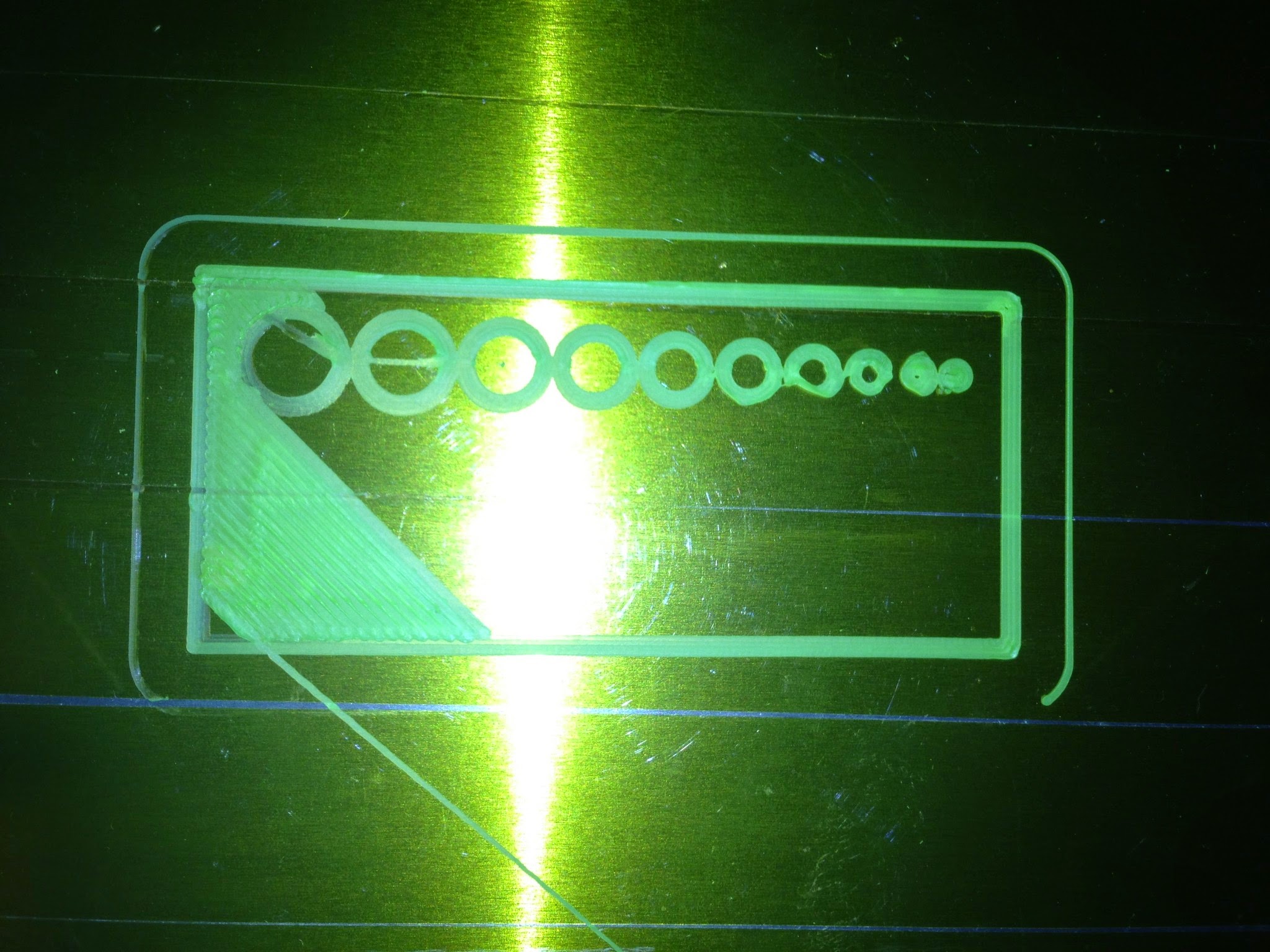

So I was sure that something was wrong when it came to the size of my holes so I made a block to see how accurate it could make it. I ended up stopping it on the first layer because I couldn’t believe how off it was. The holes start at 10mm and go down to 1mm. I measured the 10mm hole to be 8.88mm. What are the reasons this could be off. I calibrated it when I flashed the firmware. Any Ideas
You’re starting too close to the platform.
So my bed is to close is what your saying. You use a piece of paper right. I have a glass bed coming this next week because my build platform is warping around the edges.
