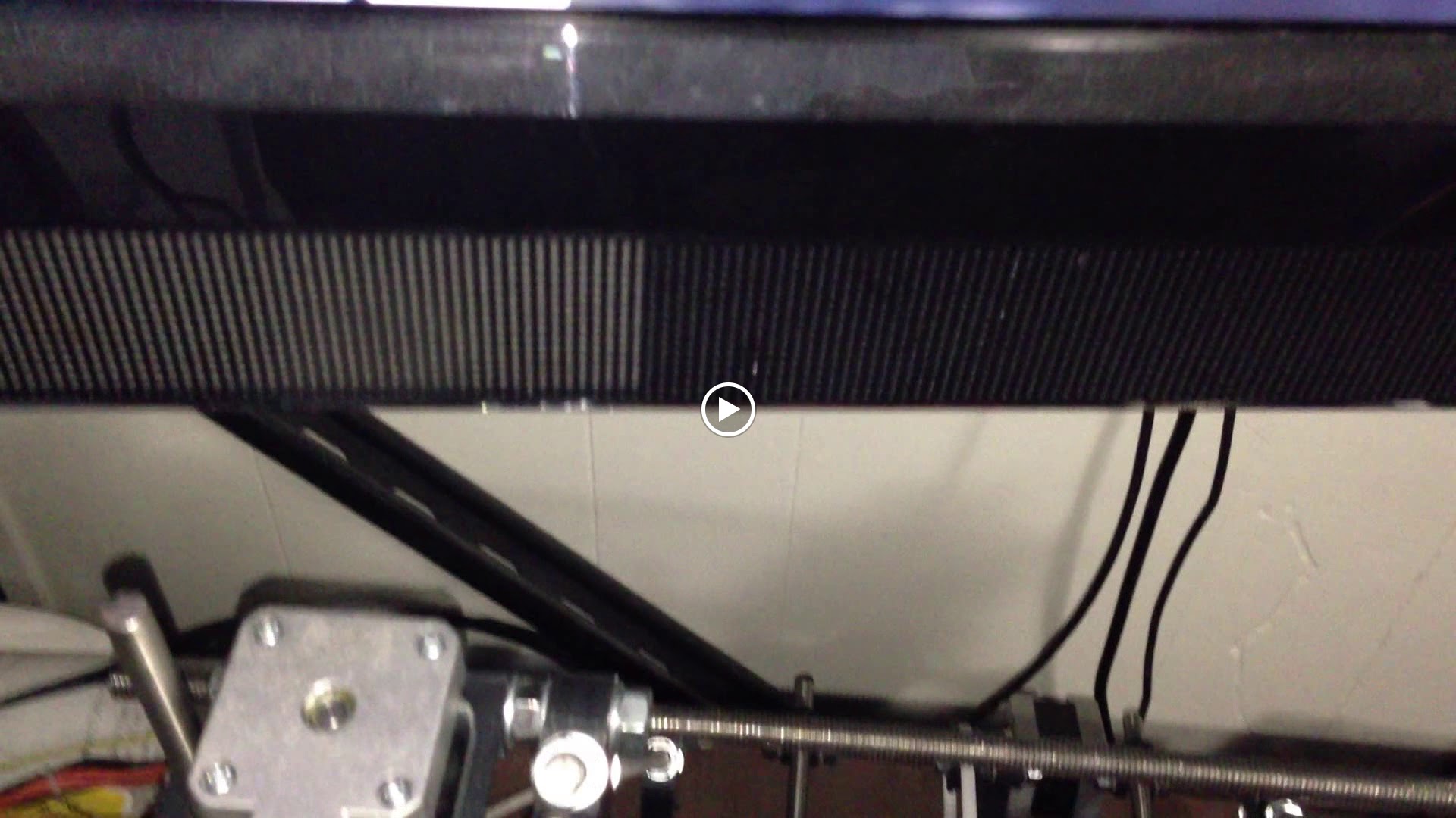

So Idk if anyone else has had this problem but when ever my steppers move or start i get this high pitch noise not sure if you can hear it or not on the video but it doesnt sound good was just wondering if you can think of anything. I’m new to this and just got my printer wired. The end stops are not working which im looking into. This video shows right after it moving just a little then the sound continues tell i click stop motors
What you’re hearing is the stepper driver’s PWM frequency, which is a totally normal thing. It can be reduced by turning down the motor current (at the expense of torque output) or by using a slow decay mode, if your drivers allow you to select it.

So after adjusting them to 0.4v I still have the same noise it did get little quieter though. I did try turning them all the way down and it seemed to turn the noise off. Also tried going a little under 0.4v
yeah .4 isnt the goal, the goal is as low as you can get it with it printing right.
ahhh now its set right sounds like music to my ears
